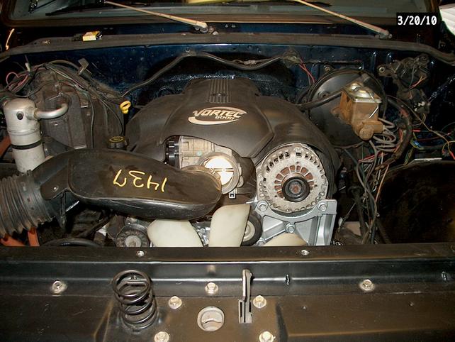

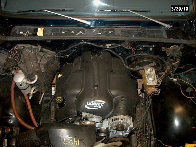

I'm putting an LQ4 6.0L 4L60E from a 2003 Yukon Denali in a 79 Sierra 2wd and it has been the easies swap. I have about 2400.00 in everything including reworking harness and ECM.
Attached Thumbnails I Wannna drop a 5.3 in my 87 Blazer K5...NEED HELP!!-lq4.jpg   I Wannna drop a 5.3 in my 87 Blazer K5...NEED HELP!!-lq41.jpg
