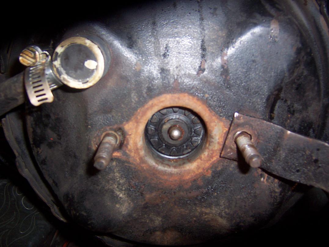

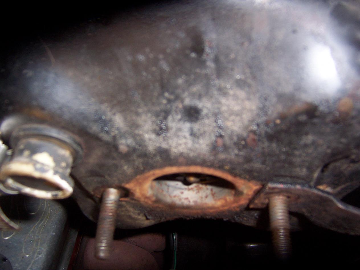

Okay, I just pulled off the master cylinder, here are some attached photos.
Attached Thumbnails Help! No Brake Pressure!-100_2597.jpg   Help! No Brake Pressure!-100_2598.jpg   Help! No Brake Pressure!-100_2599.jpg   Help! No Brake Pressure!-100_2601.jpg

Well I just took the master out so I'll bench bleed it now or try to at any rate, maybe that will solve the problem. You don't think I have to adjust the push rod then?

Apparently it is, but I have no idea how to adjust the damn thing. I gotta rig up a vice so I bleed it and I need some hose line lol to many needs not enough time.
