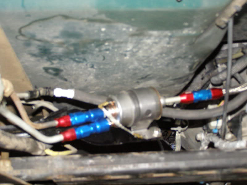

Originally Posted by iamkeniff
yeah autozone has em bu you have to order it. its a 2000 vette filter right? on LS1Truck.com there's a big write up. ive been studying it and looking for parts. i need the clam shell mounts to bolt to the motor. some hoses, a fuel pump, a harness to be reworked or made and the motor combo. i just dont want to pay 700.00 for a harness lol
I bought a WIX filter for a 00 Vette for like $30.
You can see in the pic what we did. The rubber hose coming out by the trans in the vent that goes up on the front of the intake.
We bought a 96 Silverado pump and sending unit all from Orielly's. Should be a direct drop in on the 94.

whats the part numbers for those fittings?
is there a way to make it connect to your factory hard line where your stock filter goes. get a fitting to hook to the filter then thread it into the nut type fitting it has. howd you connect the intake to those fuel lines? same type of fittings or different?
