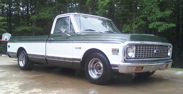

3/4 drop
and many go fast parts going on soon!
