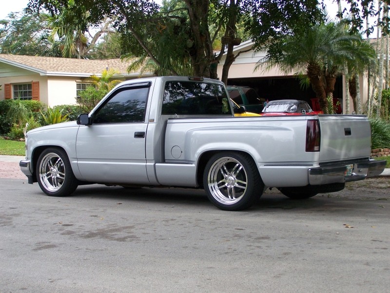

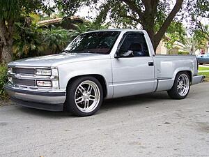

I have 20's on a 4/6. 245/45R20 in the front on 20x8 5.25" backspace. 275/40R20 in the back on 20x9 5.75 backspace.
The front tucks and looks perfect but for the rear I should've done a 6" backspace with some 285's. For you I would get a 6" backspace for the rear to get the tire away from the bedside.
