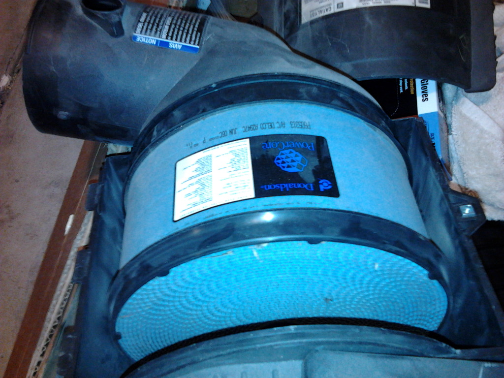

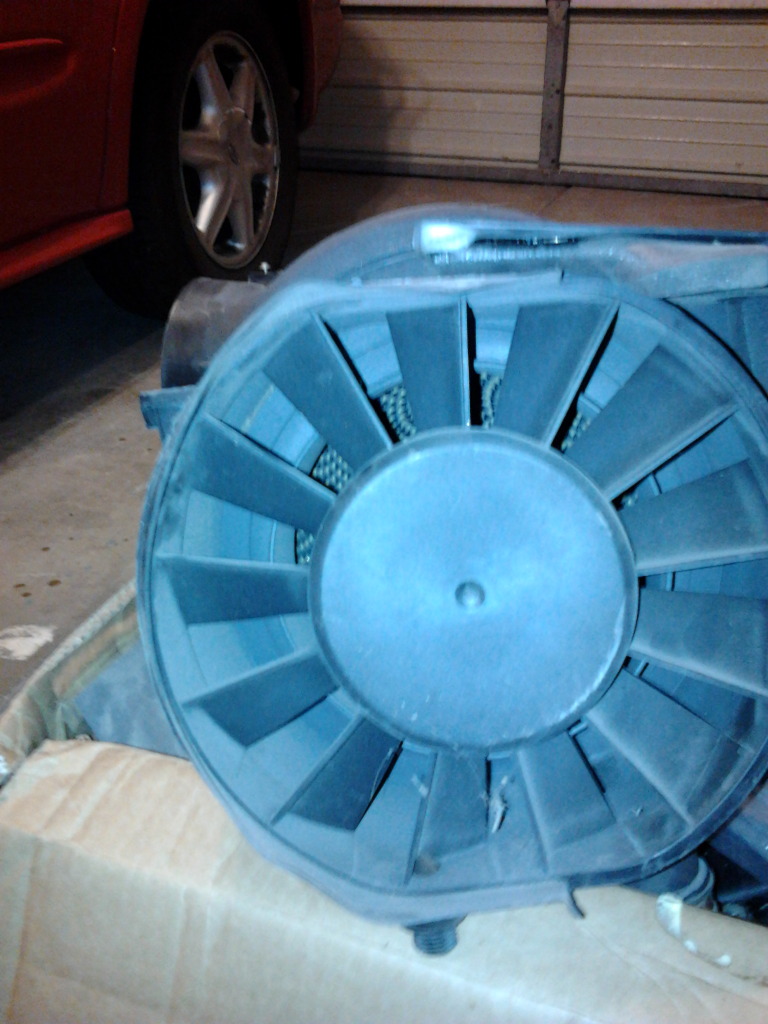

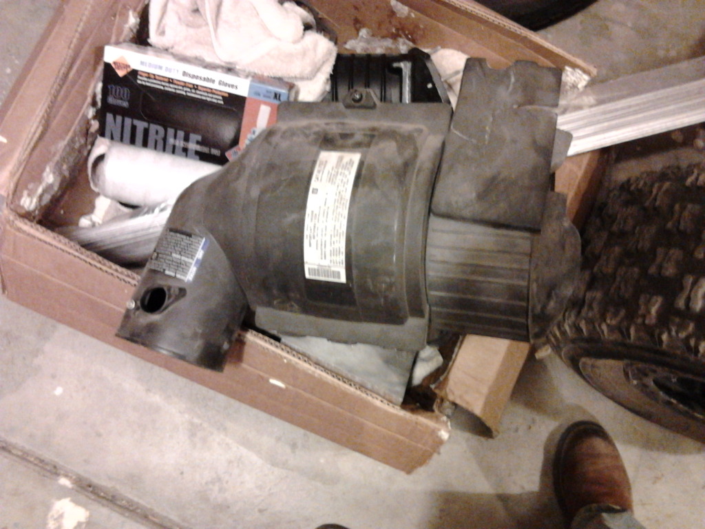

I picked up a duramax airbox from a friend last night that Im gonna run, Better flow greater efficiency
Heres the duramax airbox, Ill have to plug the MAF hole and get a silicone reducer to use my MAF. The outlet is huge its 4 3/4 inches I need 4 inch. And the outlet already curves back so itll save me a bend.

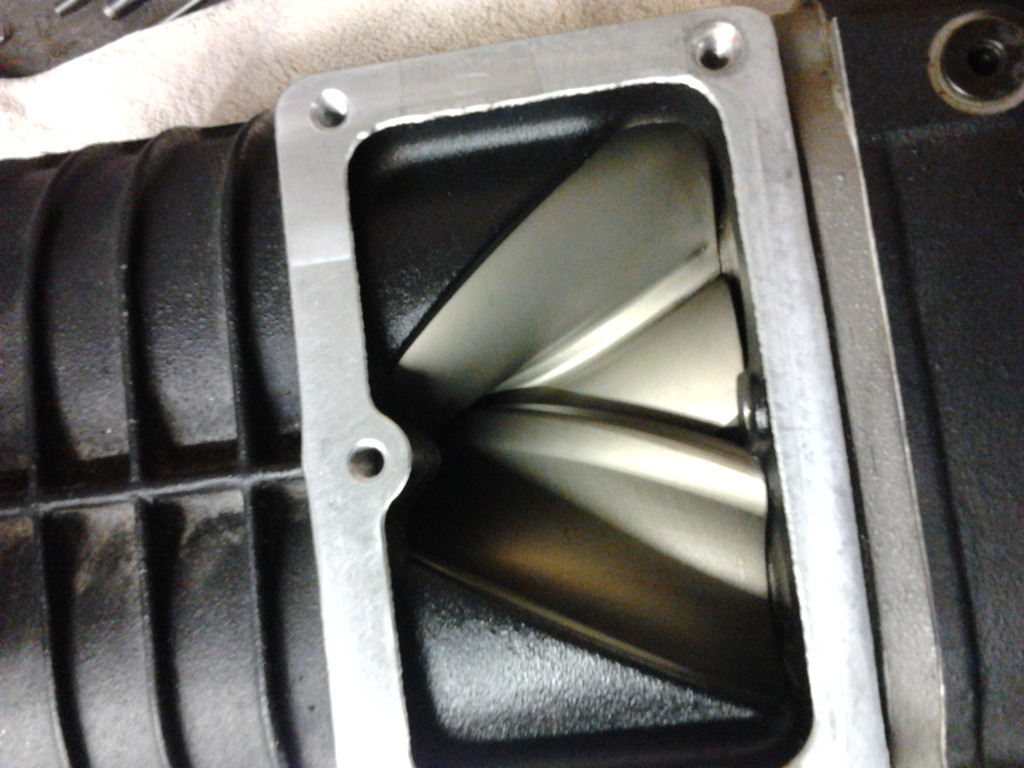

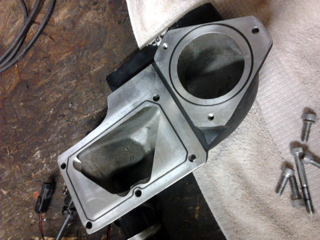

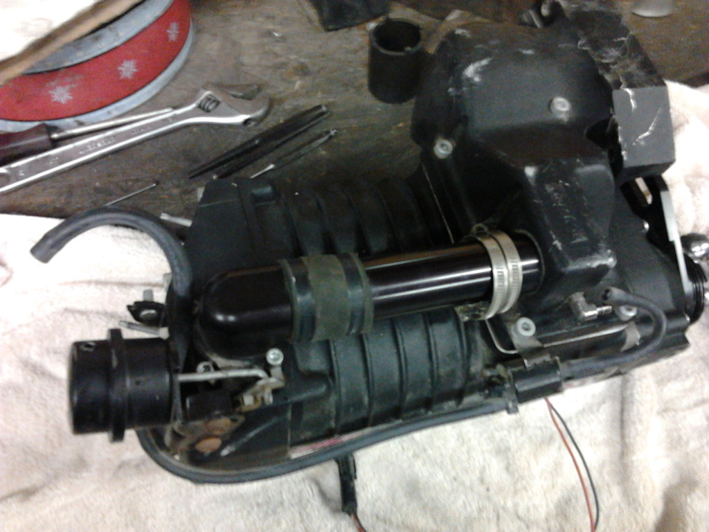

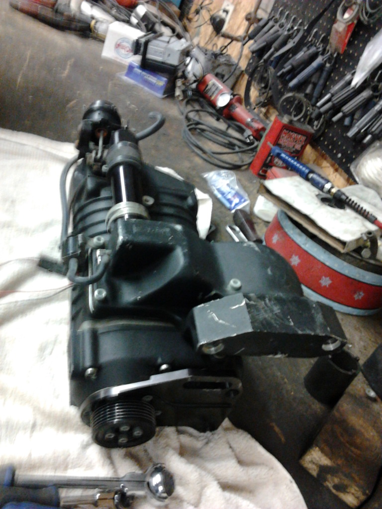

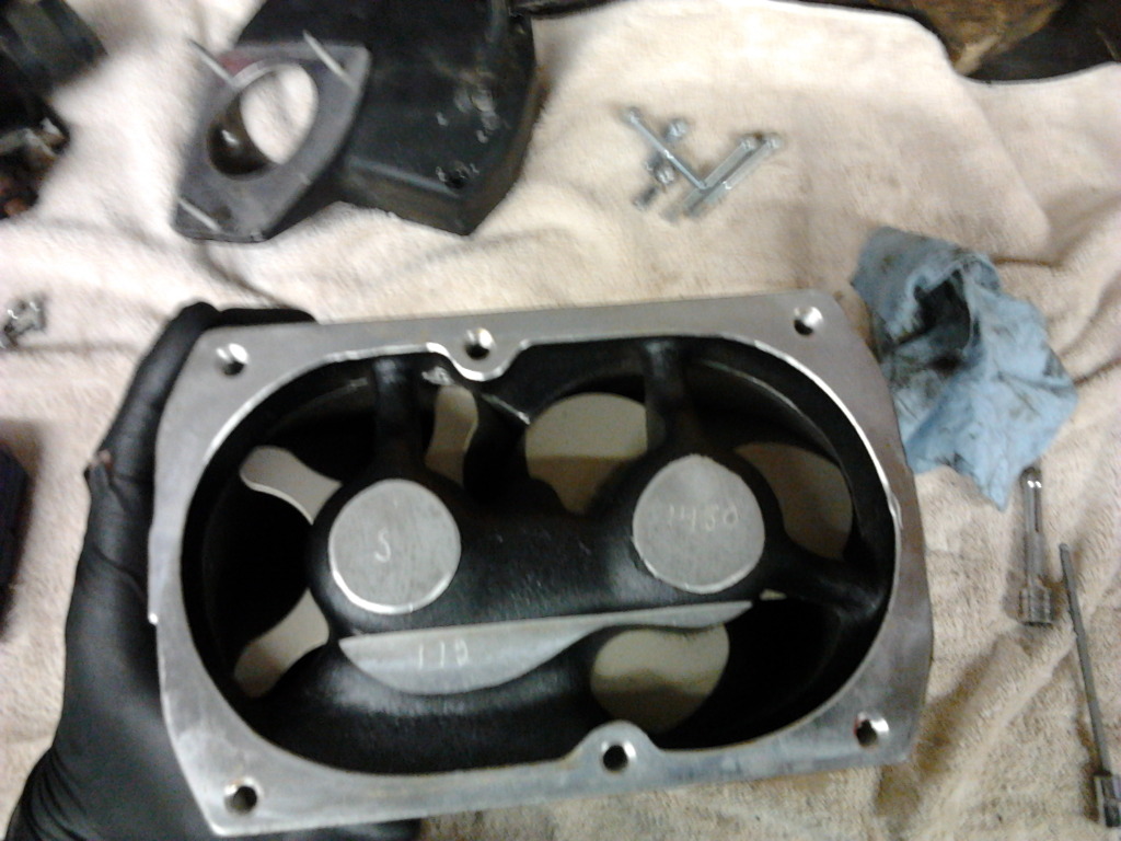

Heres some more pics of the blower and inlet/discharge manifolds

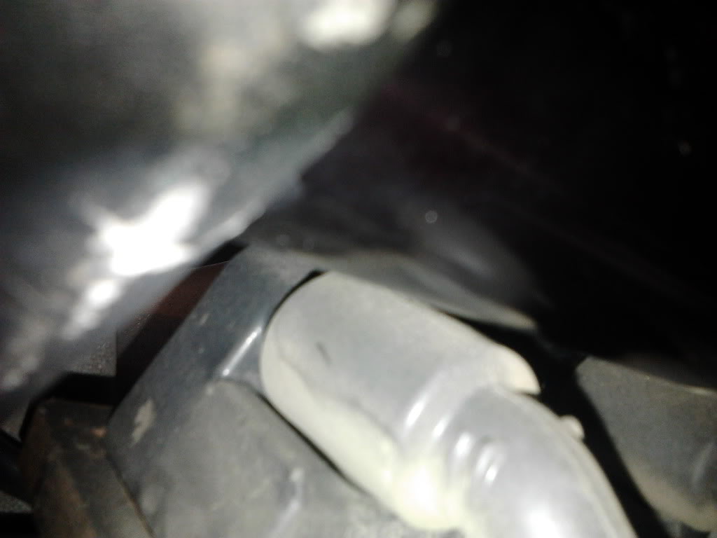

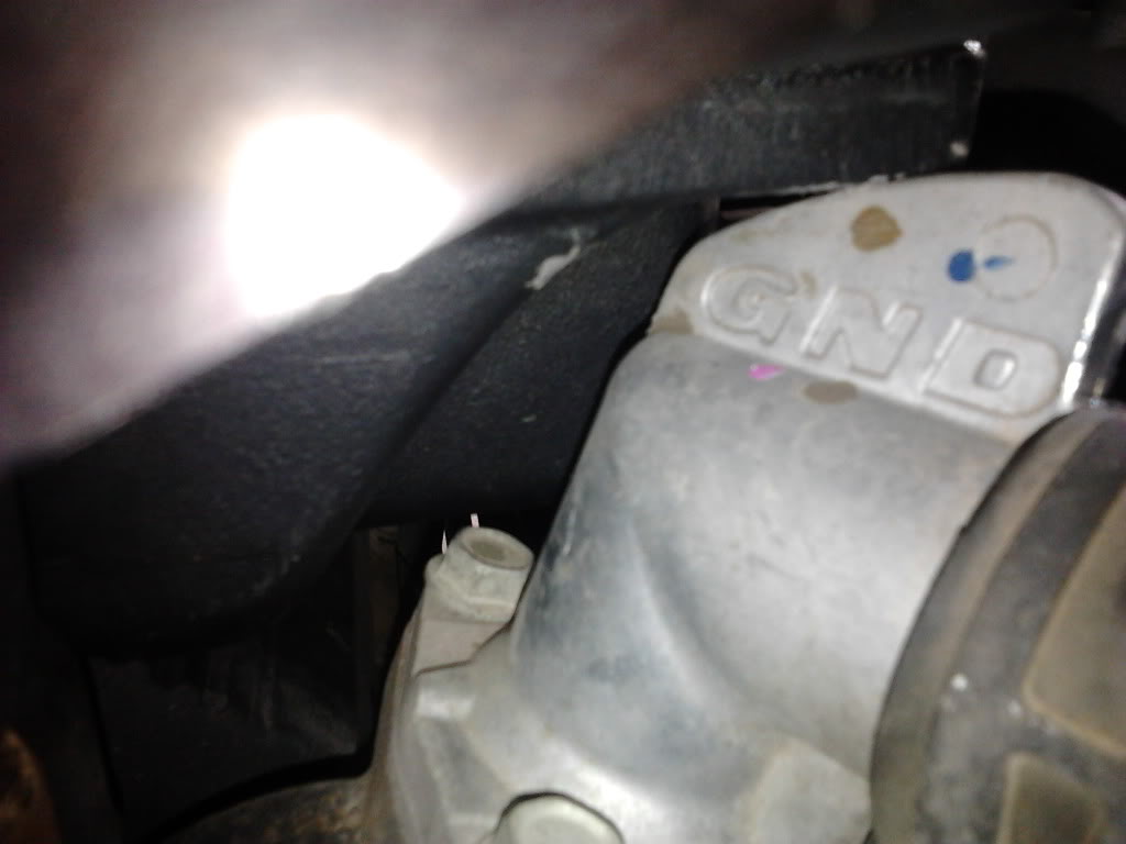

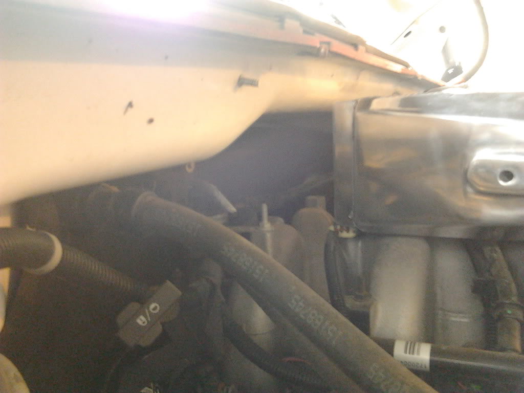

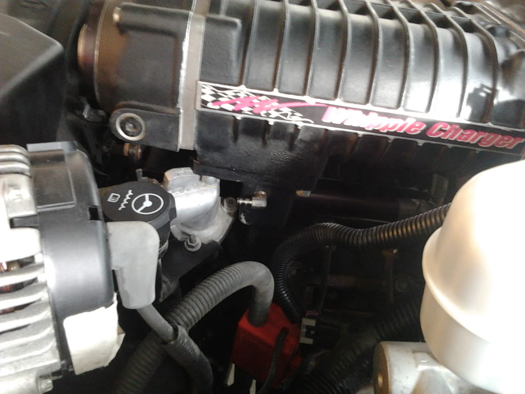

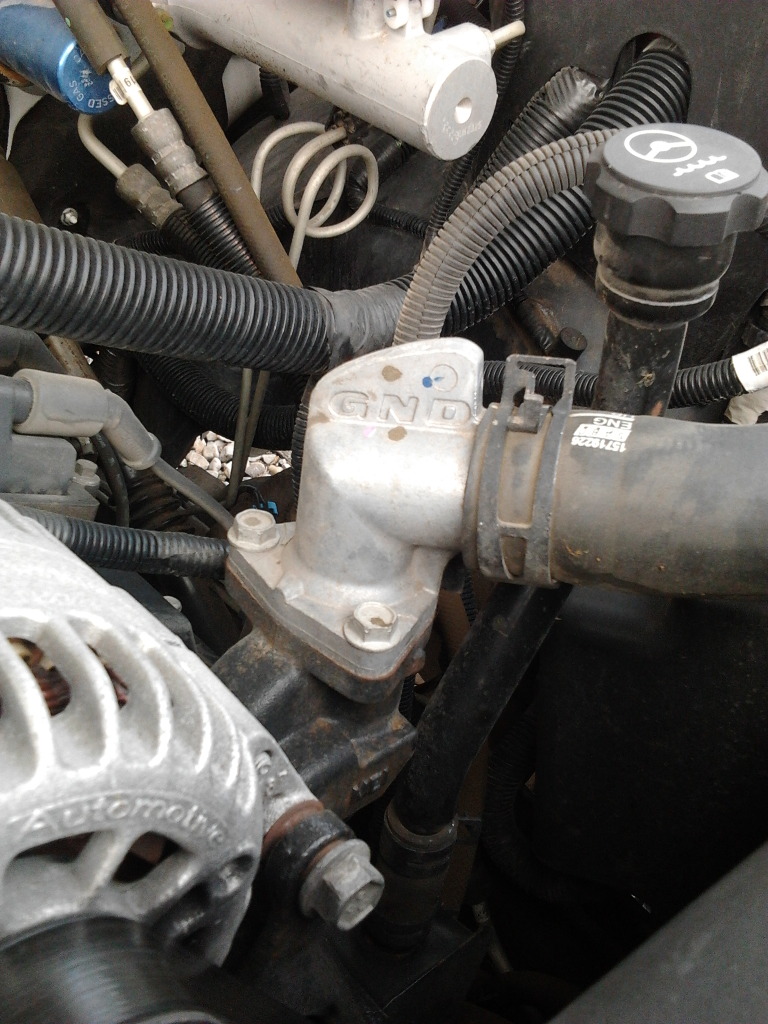

Heres a pic of the thermostat housing that will be in the way, Im hoping I can just cut the large ground lug off the top for clearance

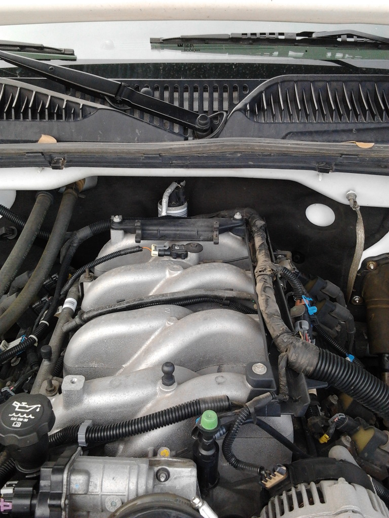

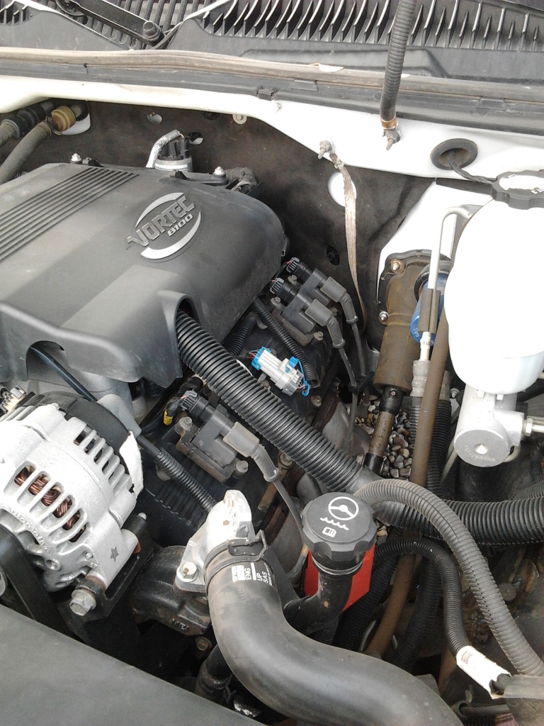

This is where the whipple goes the alternator gets moved to the other side and the wiring harness pushed back to the firewall

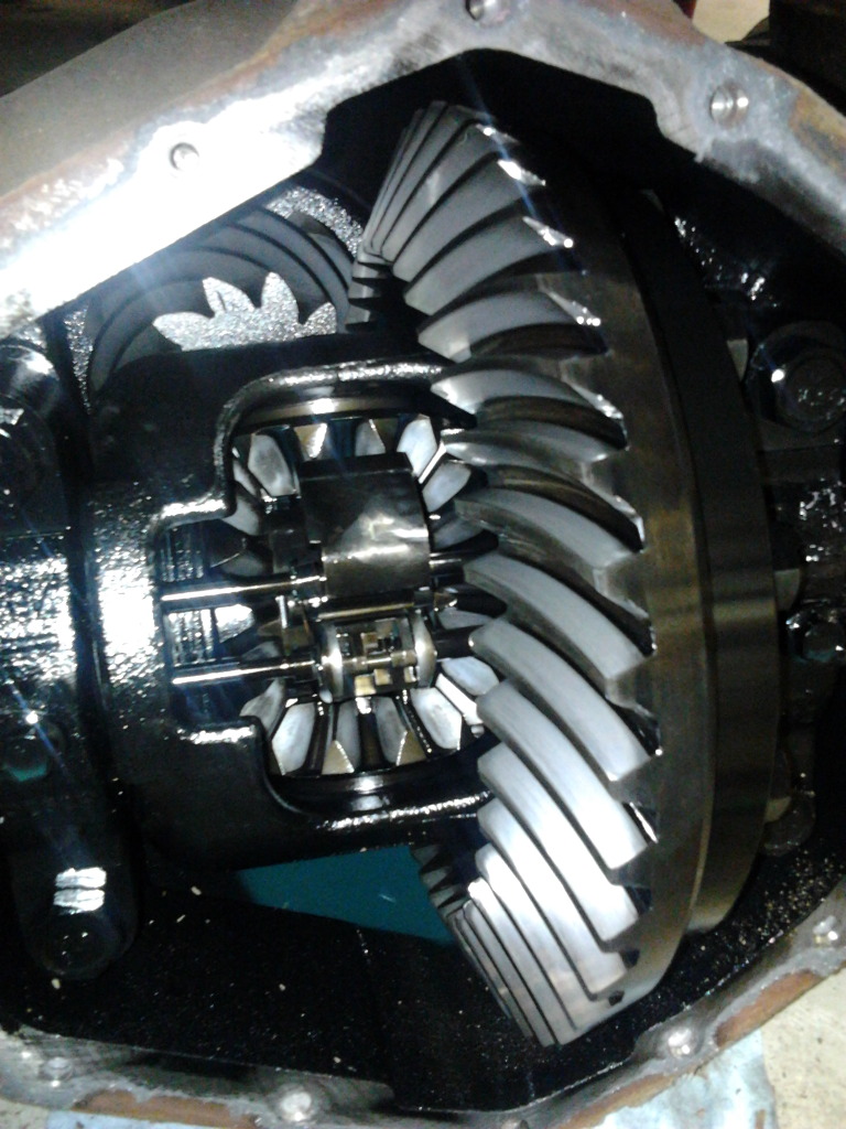

I also got a free G80 just gotta swap my carrier

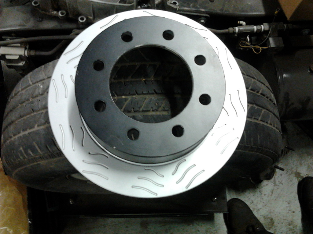

And my boss got me some rear rotors for 20 bucks at an auction

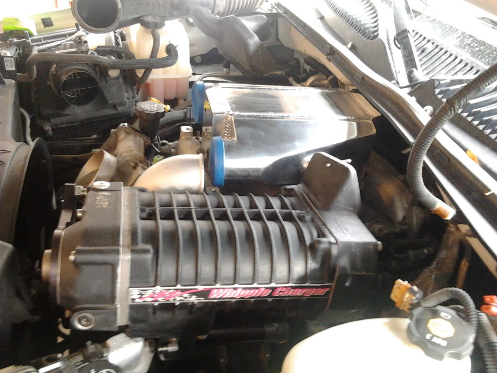

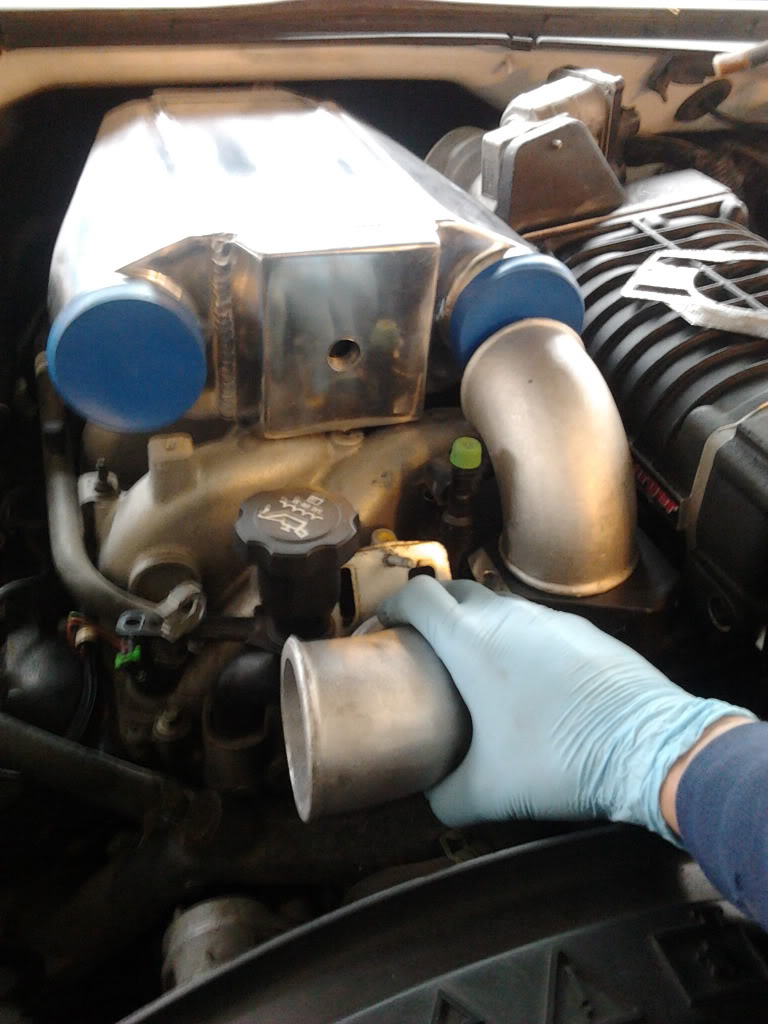

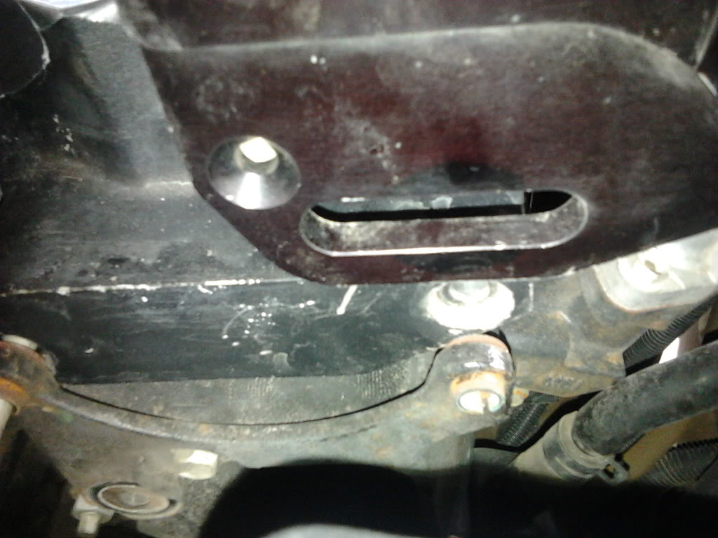

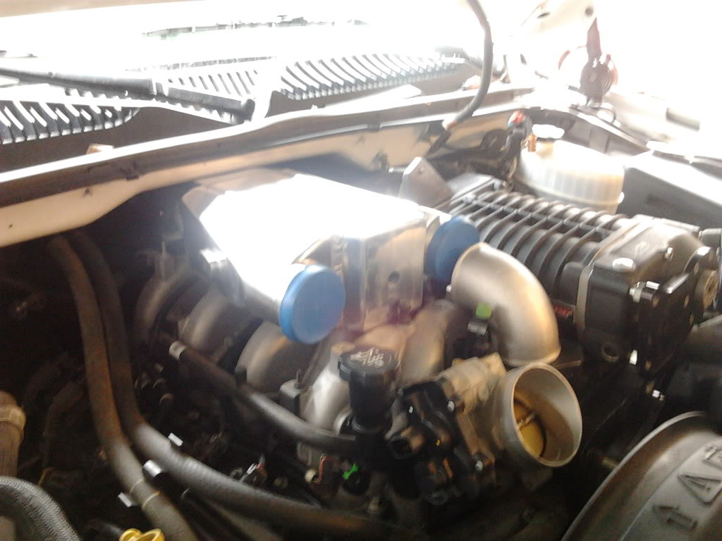

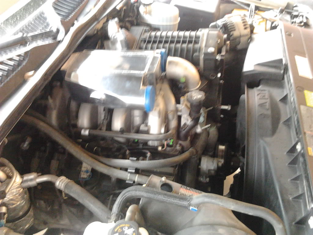

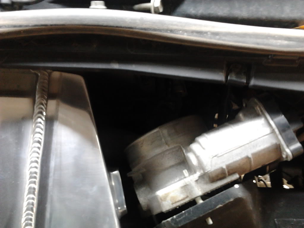

Did a little test fitting and mockup today.
Theres a few clearance issues to work out yet and a few more parts needed. Im hoping I have room to run my air intake

Got a thermostat housing made:

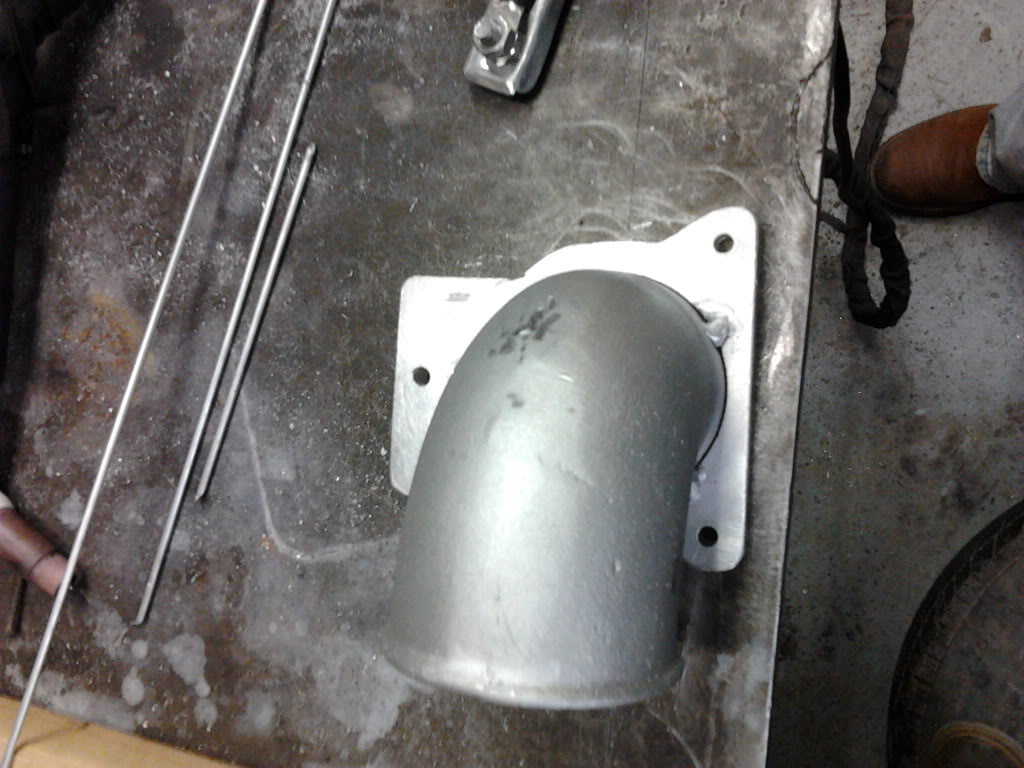

Made the intercooler manifolds/adapters, ran out of argon still need to finish welding:

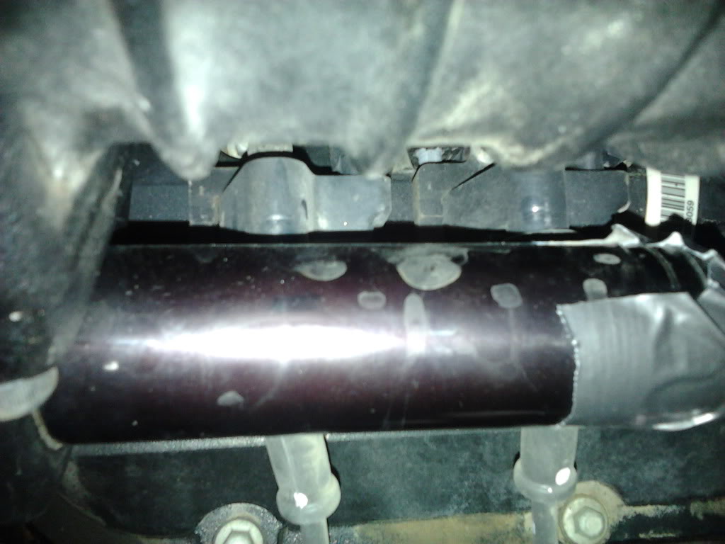

I took some pics of the fuel rail/injectors, kinda a goofy setup:
