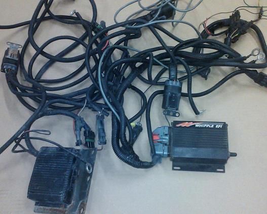

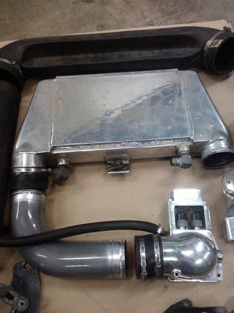

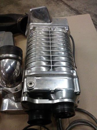

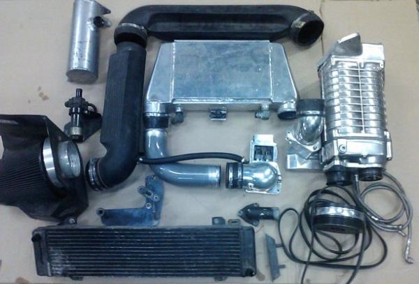

I got on ebay this morning and found this Whipple supercharger LS Big Block Silverado Sierra 8 1 GM Truck | eBay Says its missing a few pieces hopefully I can find everythin or make what I need Heres some pics

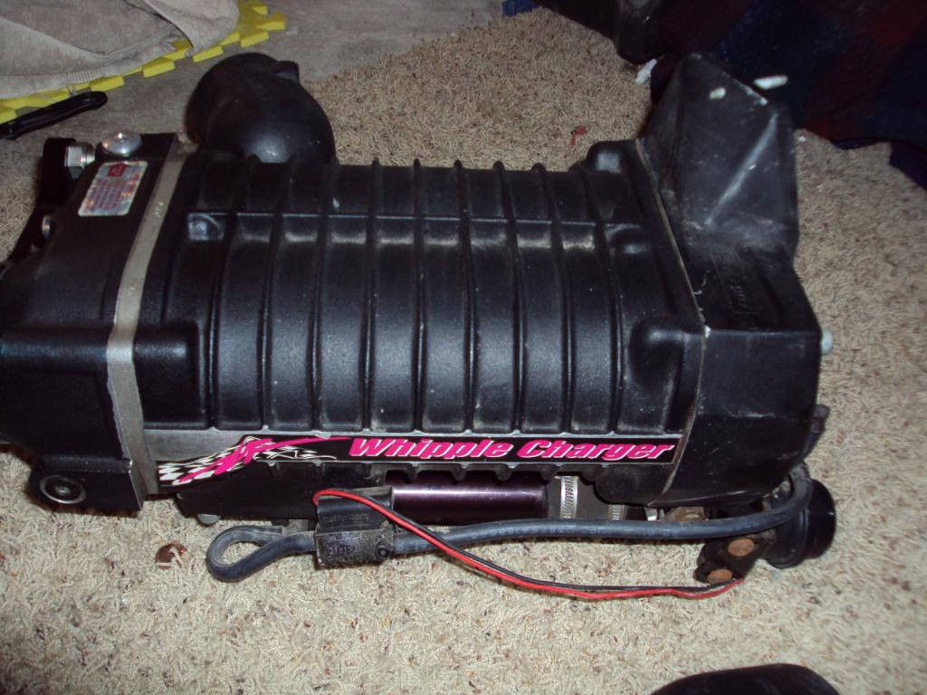

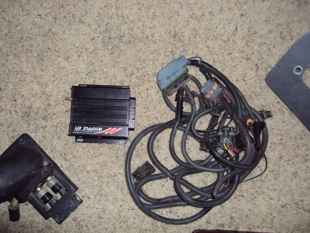

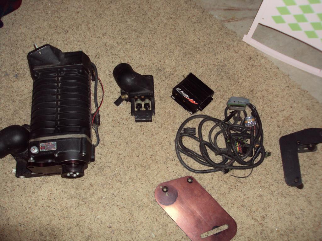

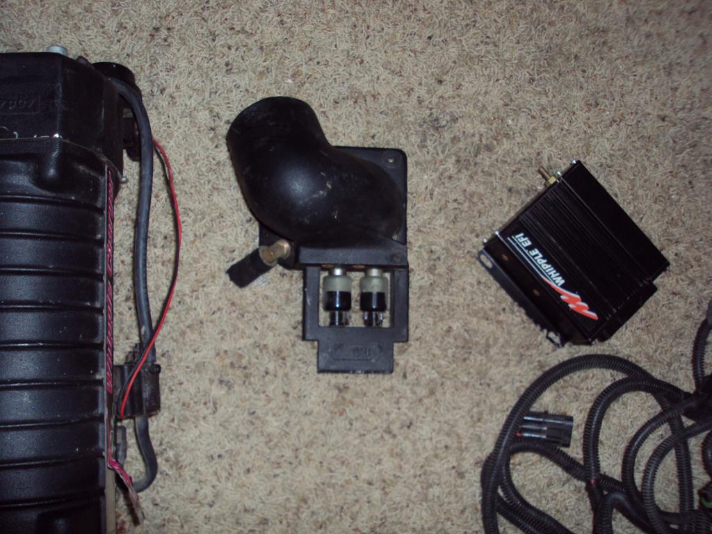

Heres some pics of other kits/installs Iv seen, Doesent look like much is missing
If anyone can share pics of thiers of help me figure out whats missing Id appreciate the help Thanks

Well emailed dennis at whipple and got a parts list and install instructions. I wont know for sure what Im missing till I actually have it in my hands but looks like for sure a water pump pulley. Iv been scouring the web for pics and besides the intake plumbing the pulley is about all that looks like is missing from the pics.

From the looks of the pics you seem to be missing a few items:
1. Water pump pulley (you already know this one)
2. Relocated alternator bracket and hardware. Cause the blower sits where the alternator does now.
3. Short alternator belt.
3. Idler pulley for the blower. There should be two pulleys on the blower bracket.
4.Tensioner bolt. The belt for the relocated alternator comes very close to the stock tensioner pulley bolt and actually rubs it. They supply a new bolt with a lower profile head in the kit.
5. If your going with an A2W intercooler you will need a new plenum adapter. the one in your pic is for a non-intercooled setup.
6. No air intake duct work (you already know this one)
7. Ditch the electronics and add-on injectors and get a custom tune with 42lb or 60lb injectors.
*****EDIT*****
Nevermind, i see the alternator bracket there on the far right in the first pic.
Have fun, you can make good power with a properly set-up Whipple.
