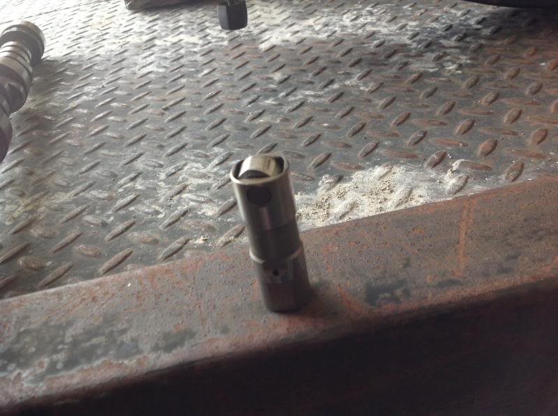

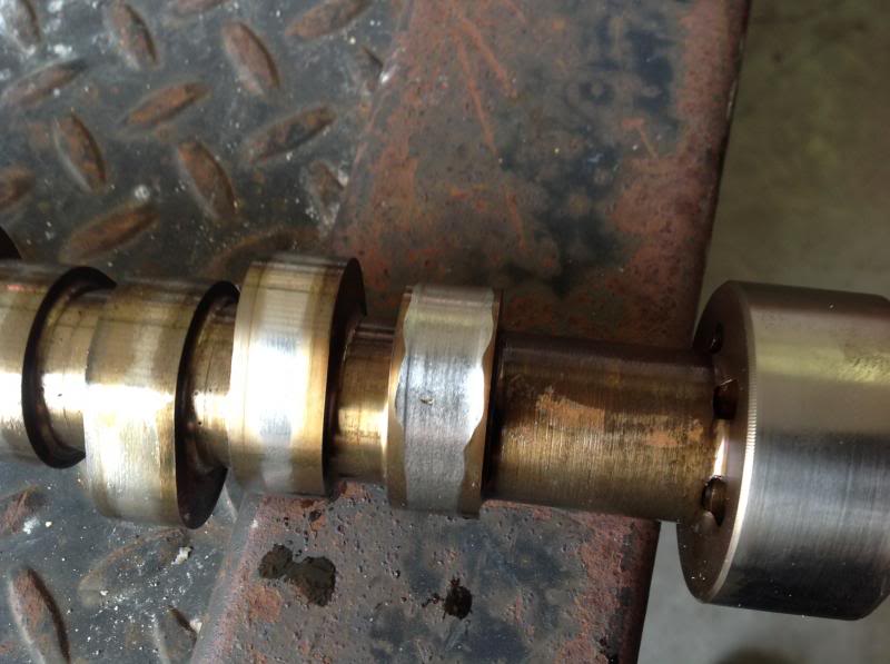

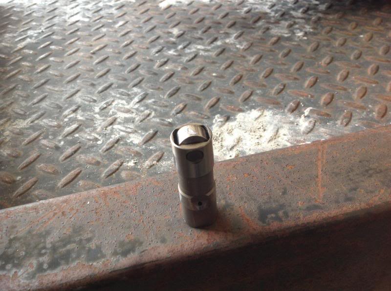

My dad told me his truck wasn't running right and misfiring. Didn't take me long to figure out it was the cam. I told him if he wanted me to do the swap then we are do it my way.
Reason for the swap.

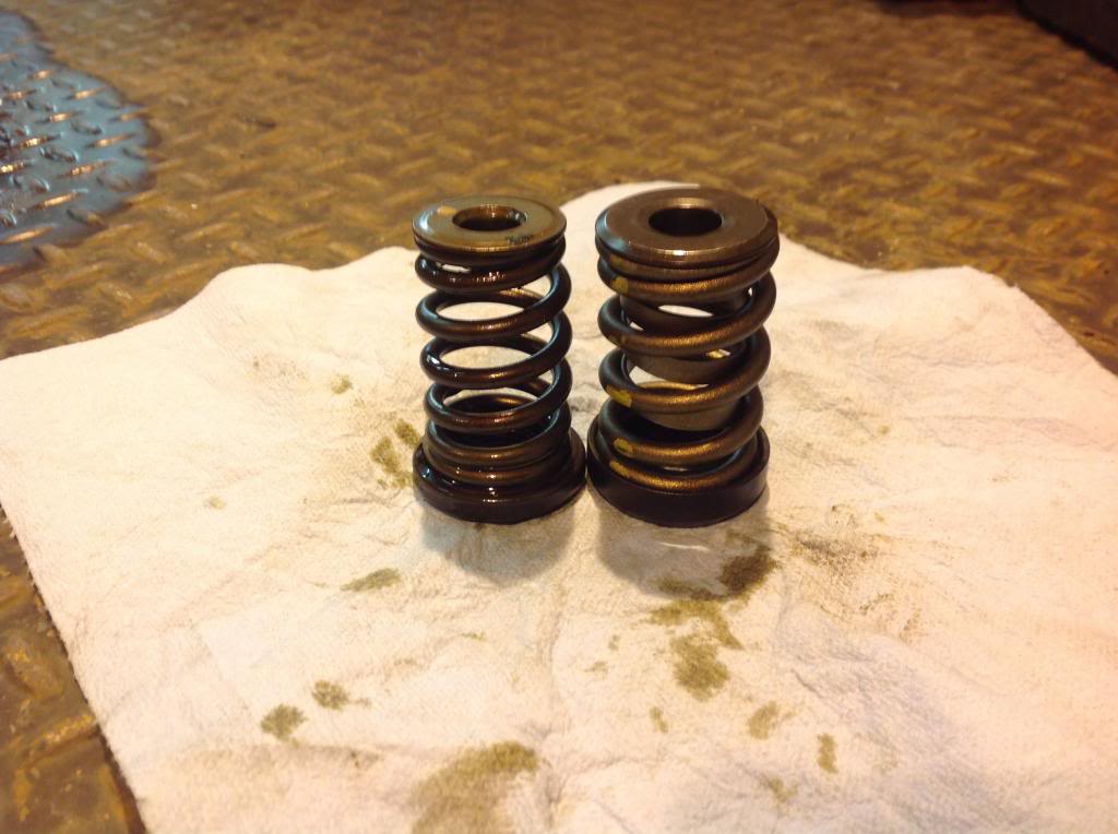

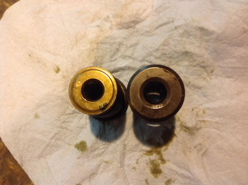

Comp's 911 springs vs stock

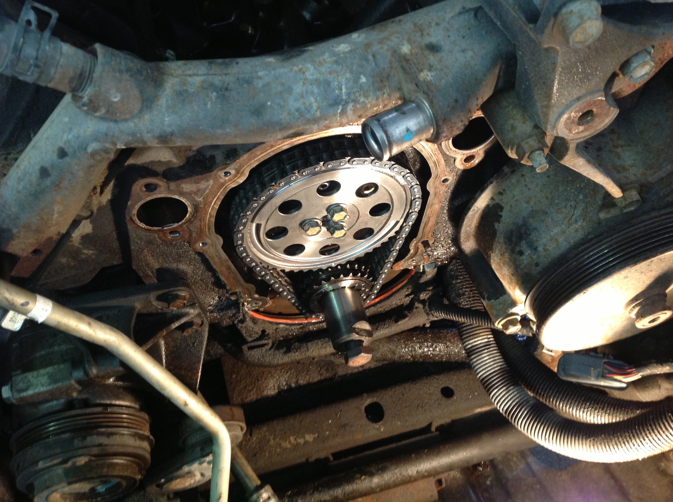

Crane timing chain

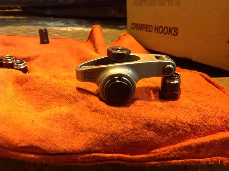

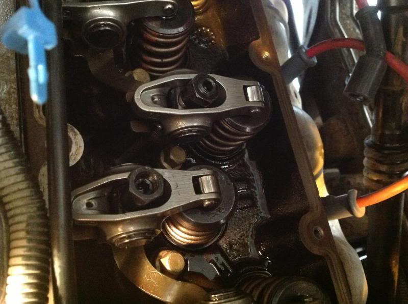

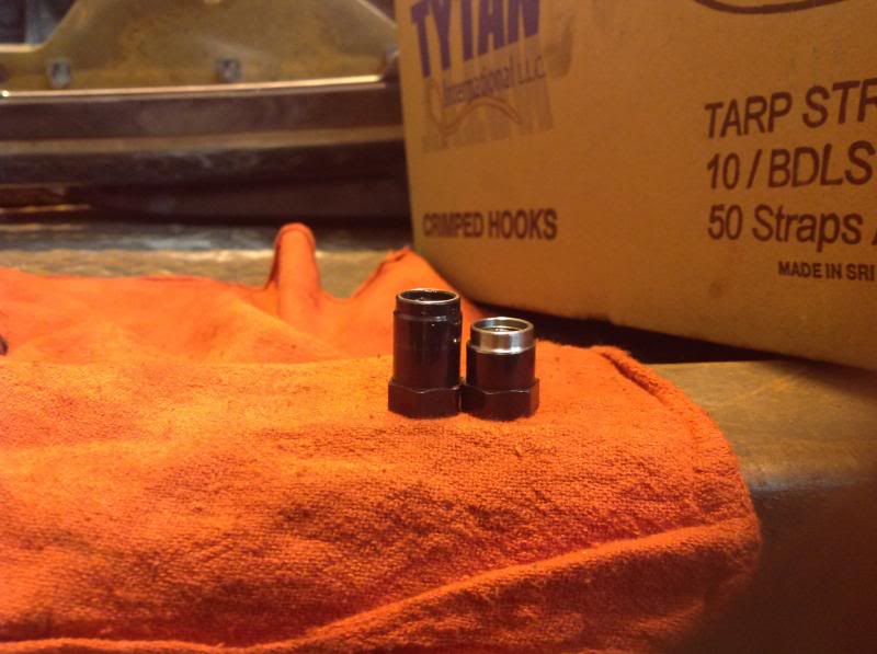

I wanted roller rockers on the truck. I had 2 options run Raylar rockers with his custom nut and keep the stock rocker stud. Or swap to ARP conversion stud and run the Comp rockers I already had. Problem with Comp/ARP swap is the exhaust polylocks will hit the valvecovers. I solved this by having 1/4 inch cut off the exhaust locks. Also had shorten the pushrods to 8.000 and 8.900
After adjustment

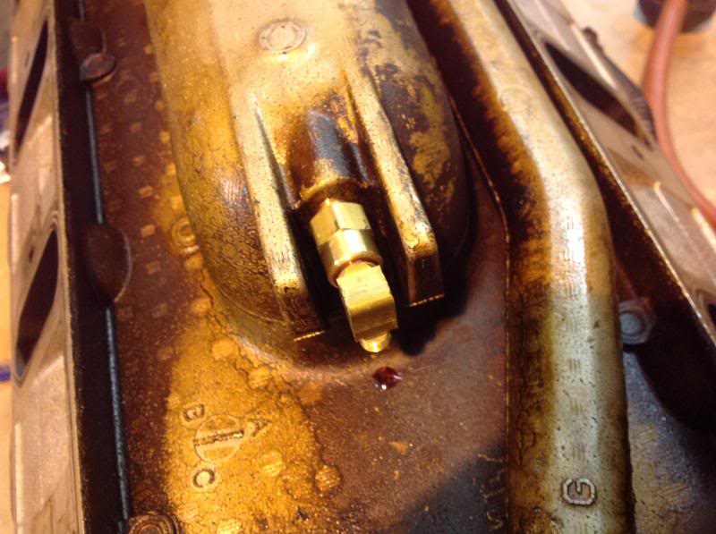

When I had the intake off. I pull the tube out the PVC port drill and taped it and added a check valve in case this truck went FI.

What caused the cam lobe to eat itself in the first place? That's what I'd be trying to figure out. The guy who built my 454 just had a 6L that did the same thing, and the guides in the heads were undersized/tight on that valve.
Old Apr 8, 2013 | 06:08 PM
xx_ED_xx's Avatar
Joined: Jun 2007
Posts: 2,229
gm has been known to have issues with soft cams. tsb's about it
