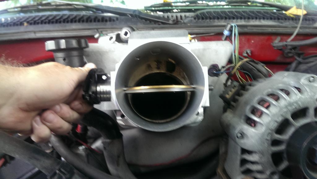

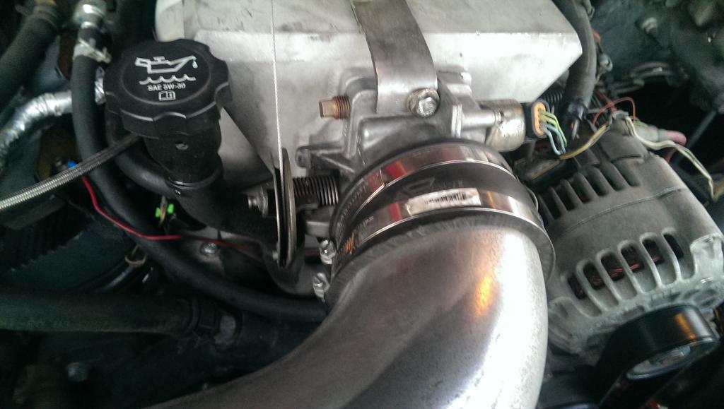

So I was playing with throttle bodies today...

Good thinking, the 90mm snout on the Cool Gap is good for another 12-15hp.
Couple things to point out on the 3 bolt to 4 bolt adapter plate. There's no crank vent in the LS2 4 bolt style throttle bodies, so you'll want to install an oil breather. In drive by wire applications, you'll want to pick up a LS1 to LS2 harness kit.
When its all put together, it'll look something like the internally modified stock manifold on the Suburban. We used a $20 stainless mesh push in oil breather from the local ORiley's and shoved it into a hole drilled in the stock oil cap.
Unfortunately, the 90mm snout on the modded manifold doesn't really show much of an effect with the ported iron heads, roughly 3-5hp past the 20hp we picked up from the modded manifold in the first place. By the time that the extra CFM the 90mm provides becomes really useable (4000 - 6000 RPM) - the stock heads are already done flowing air and are on the decline.

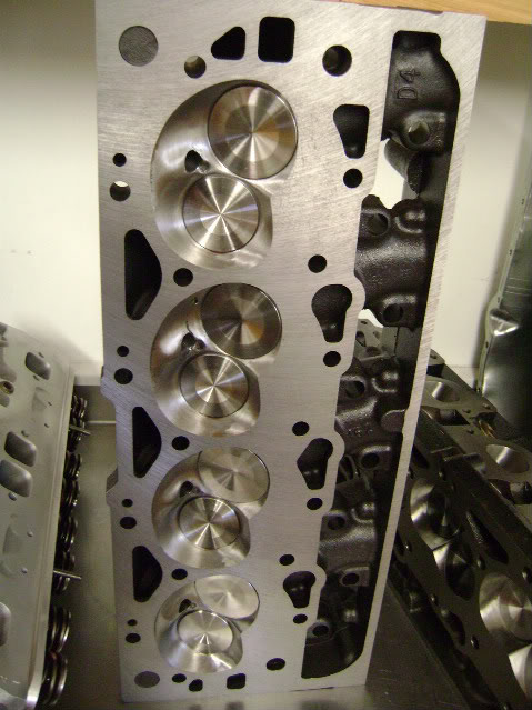

Well as soon as i find the dyno sheet here is pics of the head

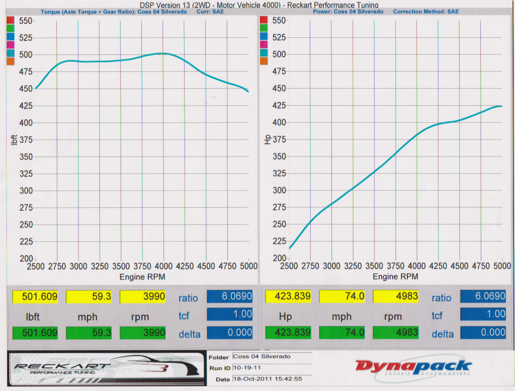

This is shorty header and stock intake and tb dyno at the wheels

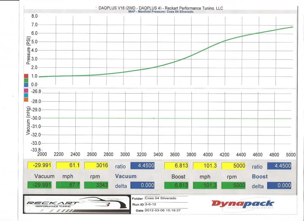

Finally found my rear mount turbo dyno sheets i swore i had them uploaded

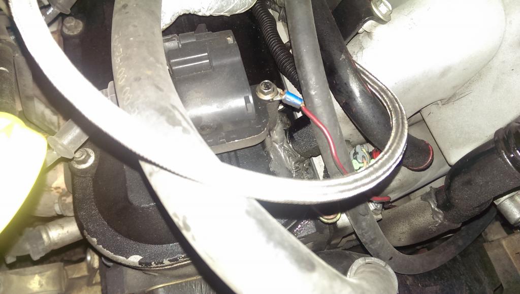

And my oil breather I had more ring gap put into it so when i boosted it my rings wouldnt be butting. so i run this homemade breather
Unfortunately when i switched to your intake and it uses the stock fuel rails it covers one of the fittings so i got to make some new ones to fix the issue so i can breathe both valve covers again.

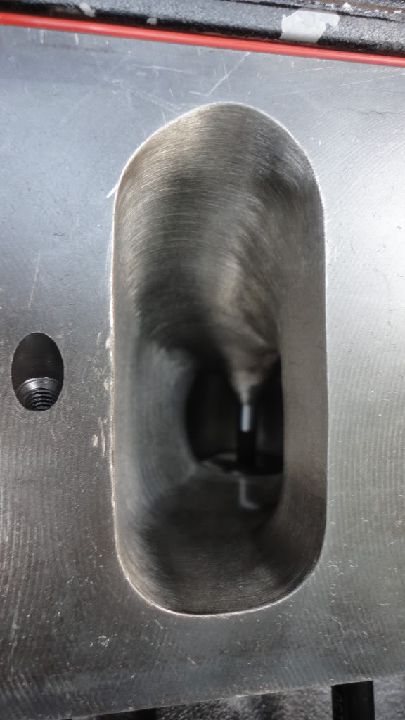

Stock tb wild mild port work
All good stuff, especially the turbo dyno.
This rear wheel dyno information for the ported heads we've seen before as a 496 MAG (base) crank output with stock cam / intake and ported heads. It would be exceptionally high for an NA 8.1L with iron heads to the ground, are you sure this isn't adjusted to crank output?
The reason I say this is that our 540cid puts out 335hp/475ft-lbs rear wheel with ported stock heads, intake manifold and 203 cam. 425hp/500ft-lbs is a wide jump over stock 250hp/360ft-lbs that everyone sees from the stock engine at the tires. Assuming those are actually crank numbers, rear wheel would be closer to 320hp/380ft-lbs, which is more in line with what we've seen from about every 8.1L we've seen with ported iron heads. 70rwhp is a pretty generous gain for ported heads.

yours was an automatic correct?
Old Sep 6, 2014 | 03:48 PM
  #98
Raylar Engineering's Avatar
Joined: Oct 2013
Posts: 134
From: San Diego
Yep, 4L80E.
We've had lots of people with Allisons make about 360-370hp / 440-450ft-lbs at the rear wheels with stage 2 Truck. Our customer supplied stage 2 truck video with the orange Avalanche made 363/449 at the tires.
Old Sep 6, 2014 | 04:45 PM
  #99
xx_ED_xx's Avatar
Joined: Jun 2007
Posts: 2,229
Thats why, the viper powered trucks same engine but would make 420-430 to the wheels with a 6 speed and 360 to the wheels with a48re
Old Sep 7, 2014 | 12:41 PM
  #100
Joined: Oct 2013
Posts: 134
From: San Diego
Ah, didn't realize that the graph was with your stick setup. I assume the above graph also includes the ZZ502 cam?
