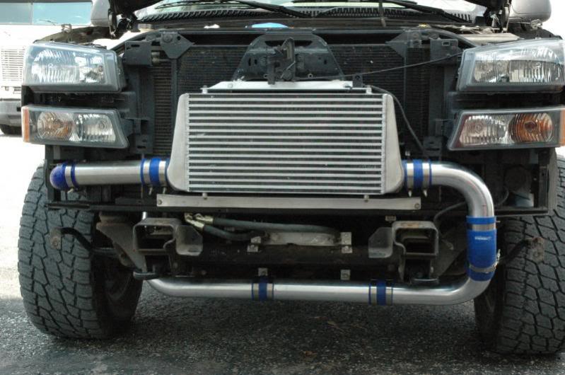

Tierod used the ole ebay special intercooler on his truck. He's got like a damn mile of piping iunder that thing.

i looked at his, i dont know how he got the grill back on.. or maybe mine is thicker or something.. i looks like he still has the support bar and all...
maybe ill go re read his post on it.

03' and up have more room behind the grill. I did relocate the trans cooler and an reroute eliminated most of the piping.

Well im going to try to cut the bar and see if it will fit.. i think ill leave the part that attaches the hood latch opening thing, and cut the rest out.. then try to stick it in there.. ill have to move the trans cooler for sure..
I think i bought the wrong size fmic.. its 31 X 12 X 3 which is freaking huge when trying to fit it behind the grill of a sububran.. I also think im going to have to run a body lift to the piping in.. there not a lot of room to work with the damn motor in the way lol..

Mine's a 31 X 12 X 4 so it should be easy fit. I think
