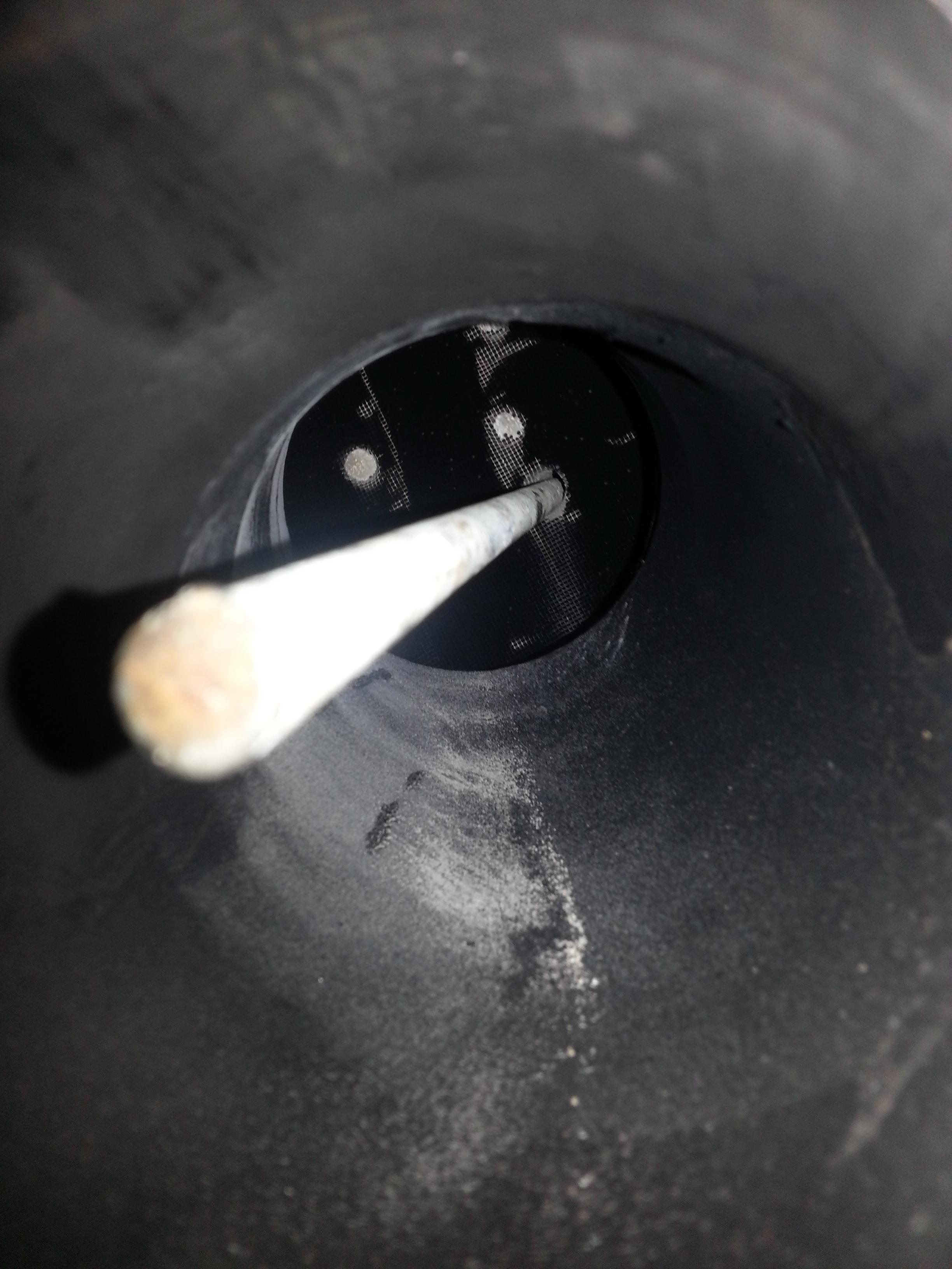

I just knocked a few holes in it with some threaded rod, once there's enough holes you can just shake it out.

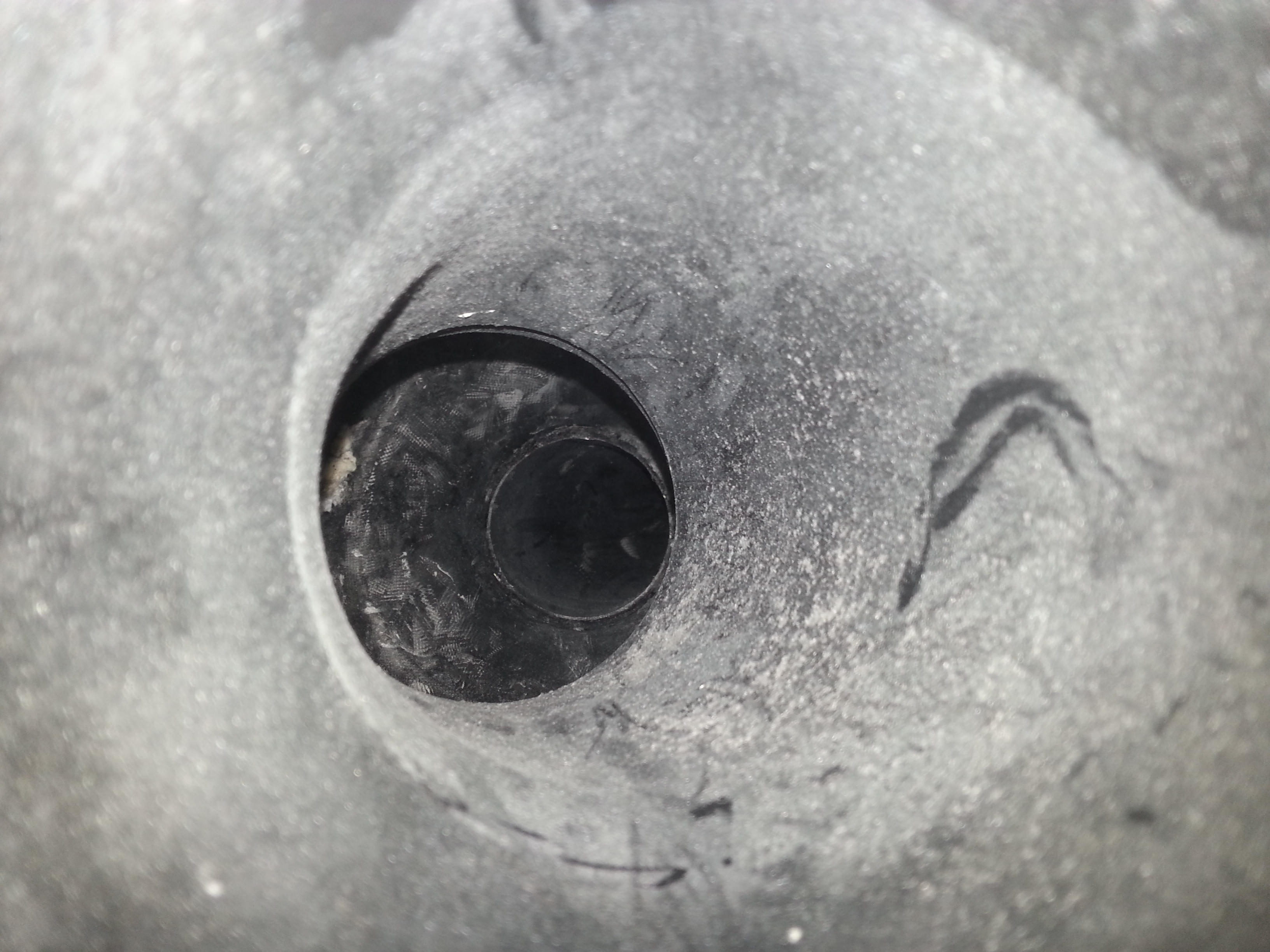

Straight through:

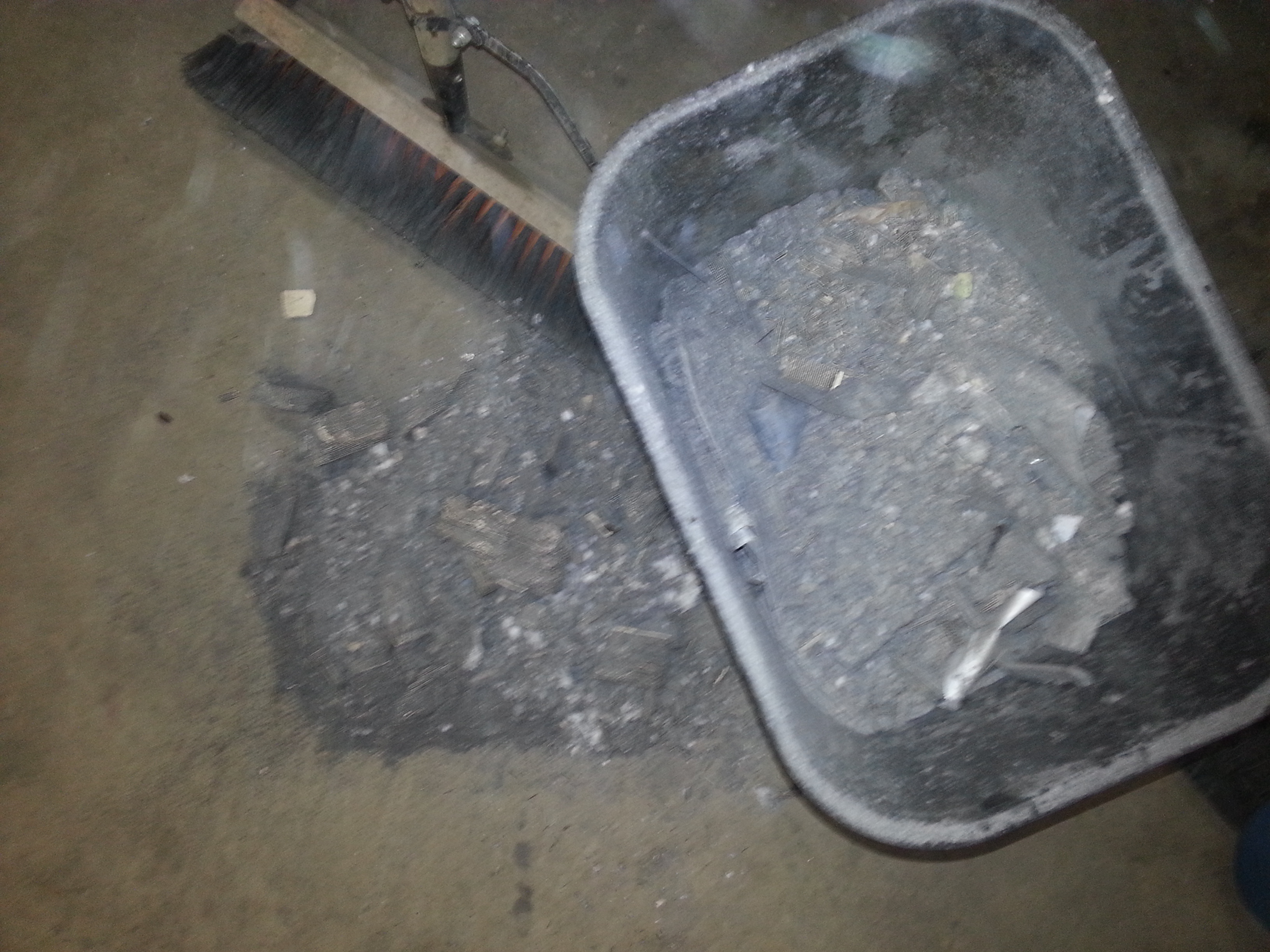

What came out of there:
I'm surprised the exhaust flows through this stuff at all:

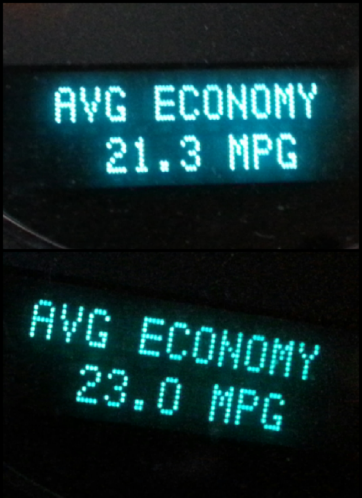

Not sure how accurate the fuel gains are, but I tested back to back on the same stretch of road, reset each time, same ambient air temperature, same speed, etc... Before the best I could get on the DIC was 21.5mpg, after the CAT delete its showing 23mpg.
Overall I'm thoroughly impressed, the turbo definitely spools faster, and feels more responsive.
Straight through:
