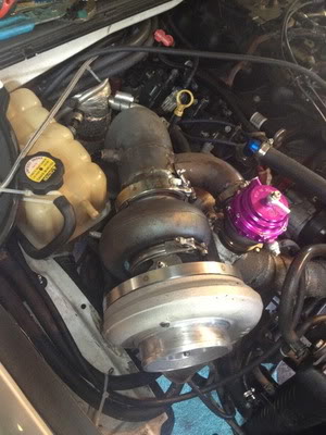

Figured, I would put my rig up on here, its my daily driver, and I drive it hard.
BW S475 turbo, custom hot/cold pipes, 4" downpipe, Stock bottom end 2006 LQ4, Isky racing cam 212/212/112lsa cam, 75lb injectors, Jakes performance stg III 4l80, Yank PT3200 convertor, 14bolt full float rearend with welded spool. Running 2 wahlbro fuel pumps, custom cal-trac bars.
I run 11lbs boost and it went 12.34@112mph before I put the Jakes 80 in it.

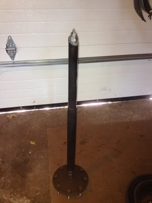

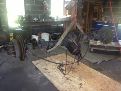

Stock Semi-Float axles are weak

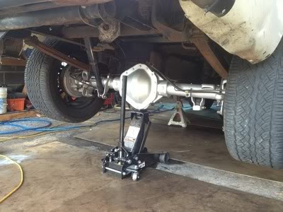

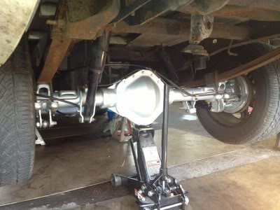

14 bolt Full Float from the junkyard

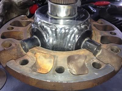

made me an unbreakable welded spool and l love it!
