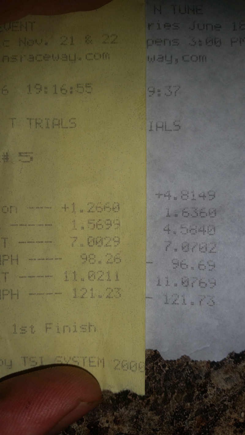

70mm on left from Jan 1st -900 DA 78mm Right +900ft
