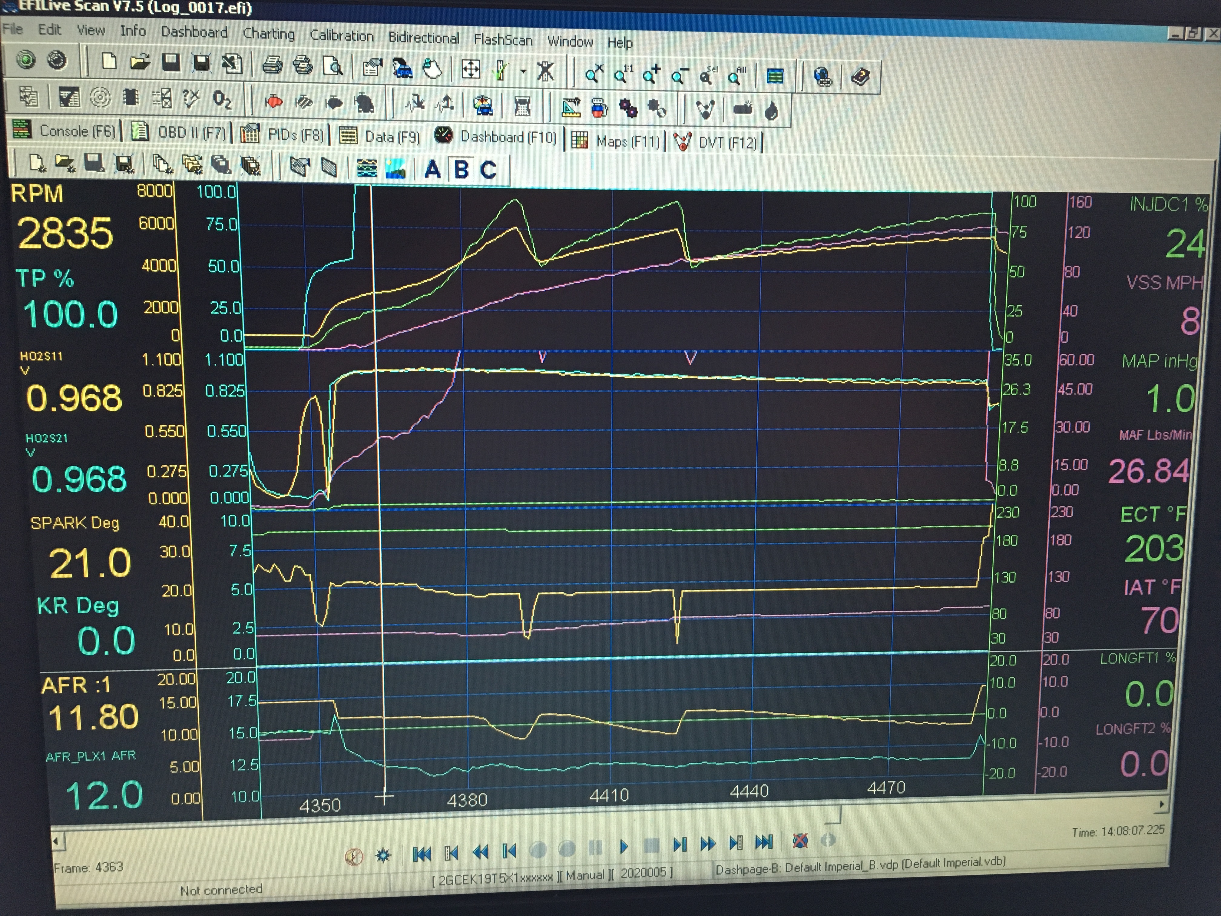

I run 50/50 meth,water and it starts at 2psi and ramps up to full spray at 9psi. I'm seeing 16psi at my 6000 shifts. In the lower rpms out of the hole I think I could add timing. I put a pic of one of my last passes at the track.
As seen in pic when I launch I'm at 21 degrees then it ramps down as boost and rpm climb. (Procharger = linear boost with rpm)
What amount of timing would you run in these lower rpms that I only see in first gear and then by 4000 it would be down to 18?

Hard to say withou seeing a log, kill your TQ management and get a cooler t-stat in there.

What would you need a log of? That's the log of a pass at the track. I run the tm because I broke hard parts on this 80e twice(a stock input and then the pic below with a billet input).

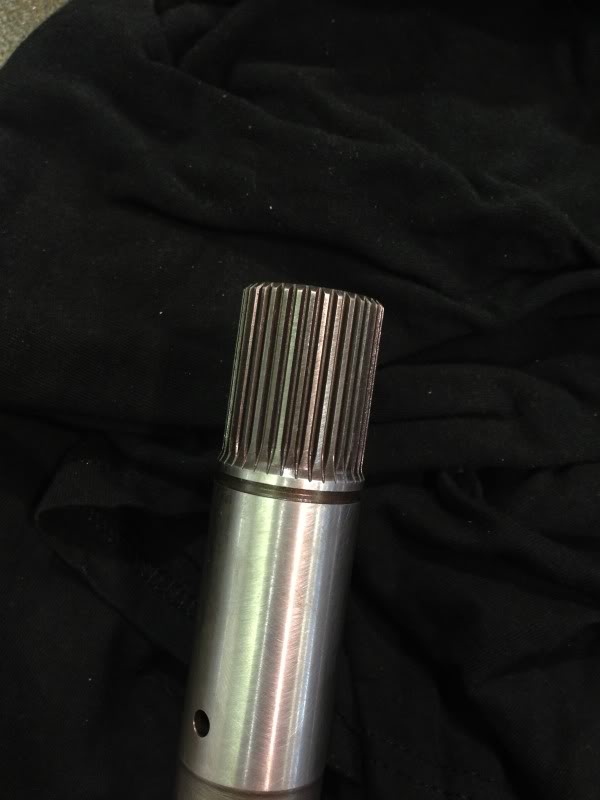

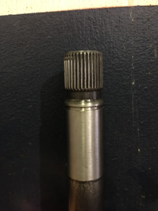

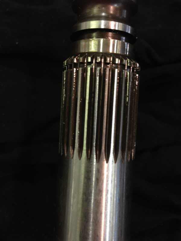

Not all billet 80e shafts are created equal. Find a billet shaft that blends the splines rather then ends abruptly with a seam. That's where they all break. As for what to see, a screenshot doesn't give a whole lot of info. I mean the ability to actually scroll across it and compare MAP, fuel, spark etc. not so much a screenshot.

Old Apr 2, 2016 | 08:01 PM
03sierraslt's Avatar
Posts: 19,007
Likes: 221
From: Western PA
Stock style, also same as many billet ones.

What I am refering too

Other end. Stock style

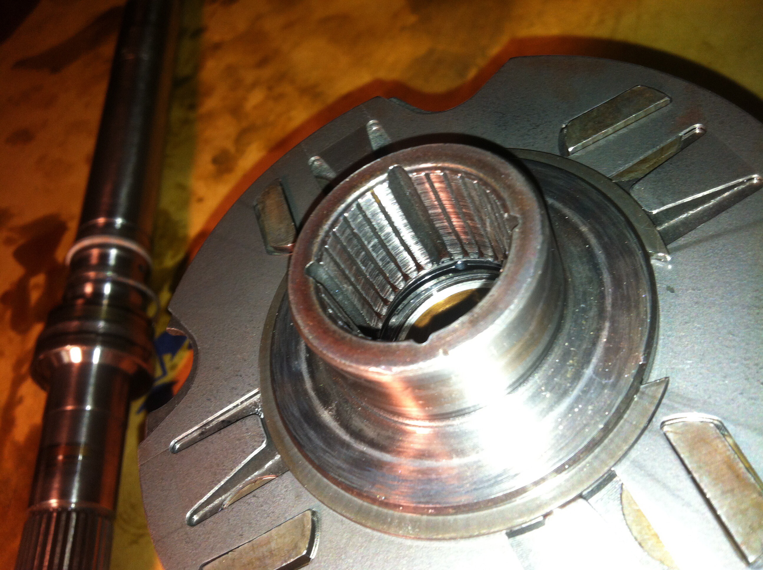

What mine is
