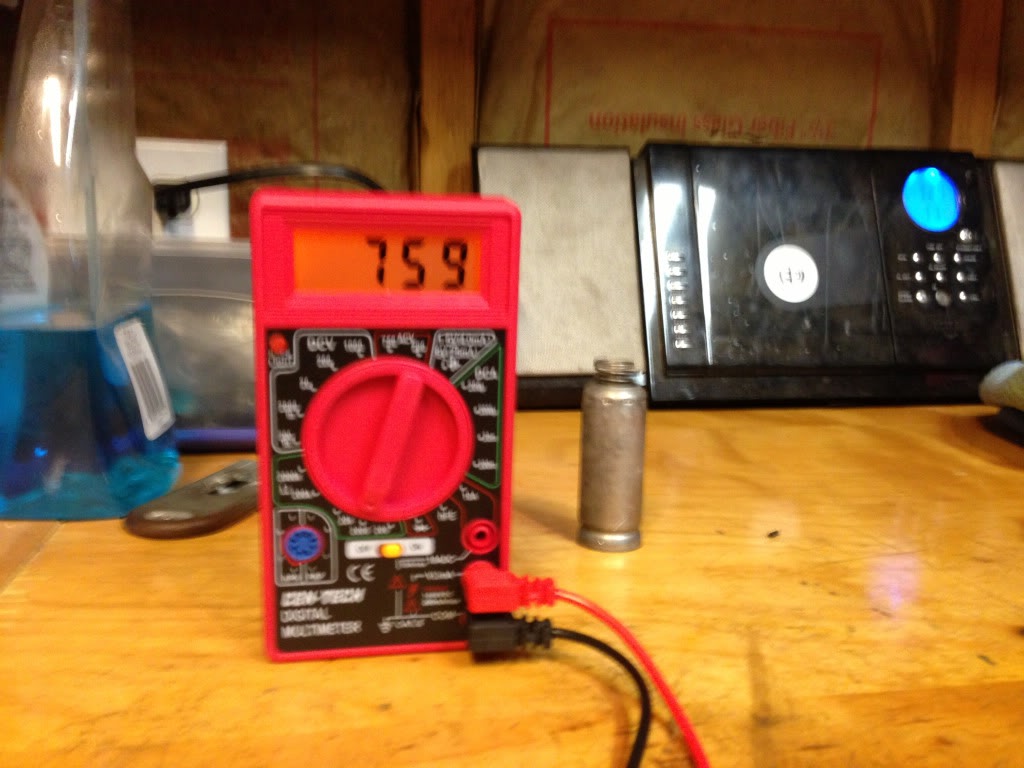

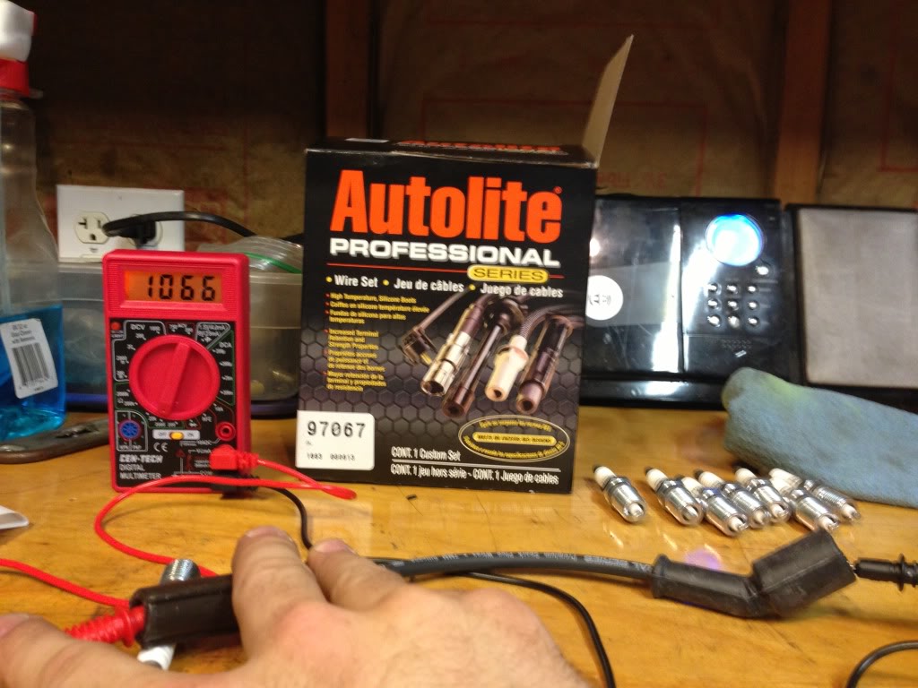

All tests were done with a brand new meter on same scale
Stock AC Delco that I removed
New factory replacements from Autolite

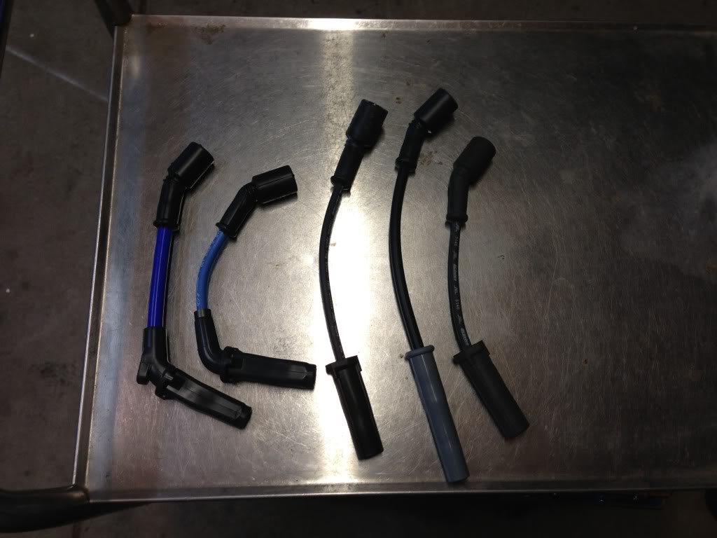

Side by Side
Taylor, Granatelli, Autolite , MSD , AC Delco
Every wire fit in the stock heat shield. I have single pics of each wire but this pretty much sums it up.

Winner of the Ohm test = Granatelli
Winner of the Fitment test = Granatelli
From my personal test if your going to spend the money for good wires, there is a clear winner. Hope this thread helps everyone.

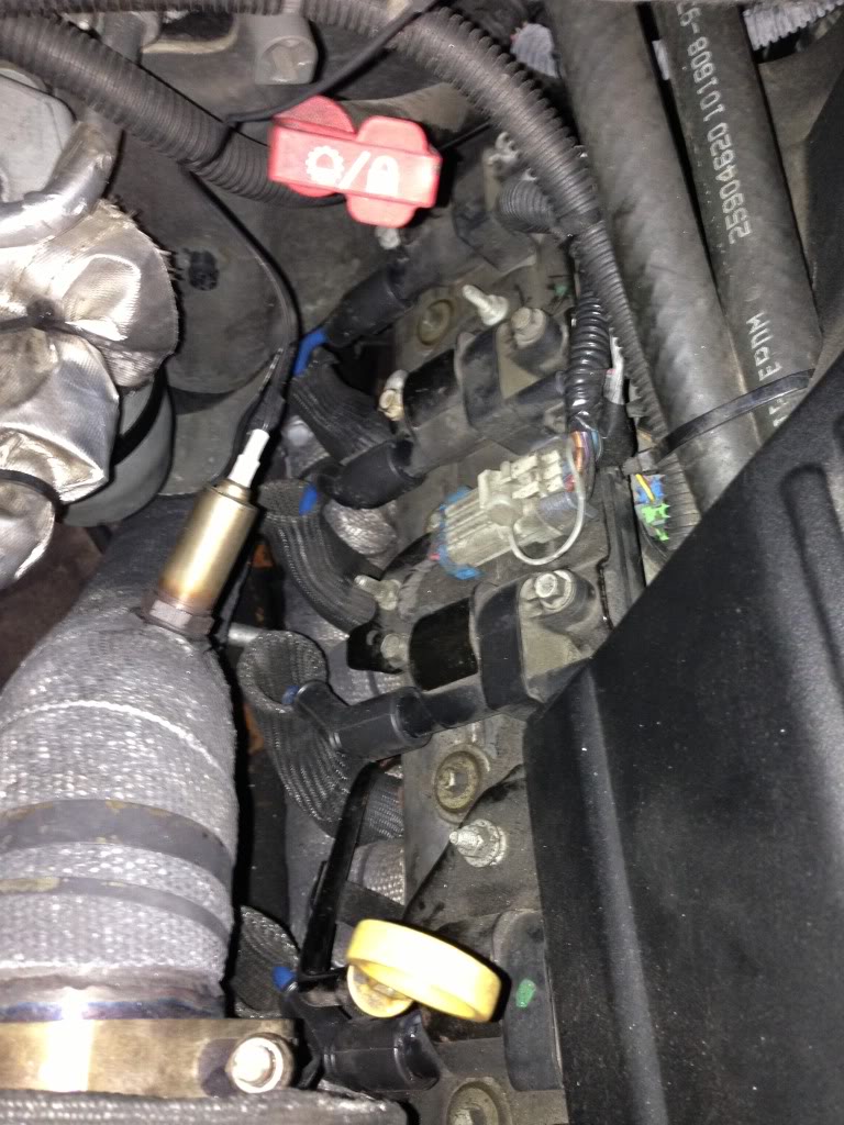

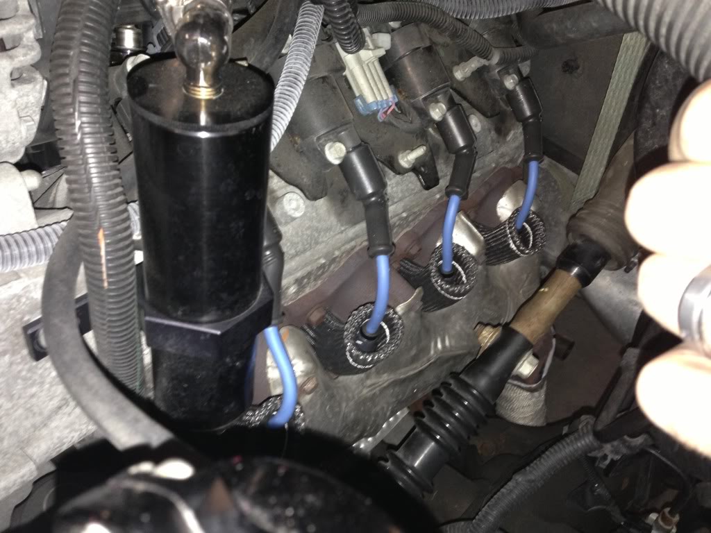

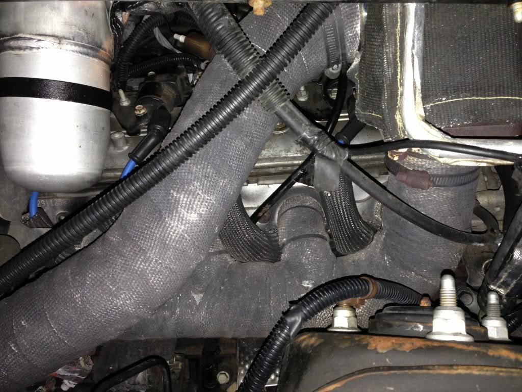

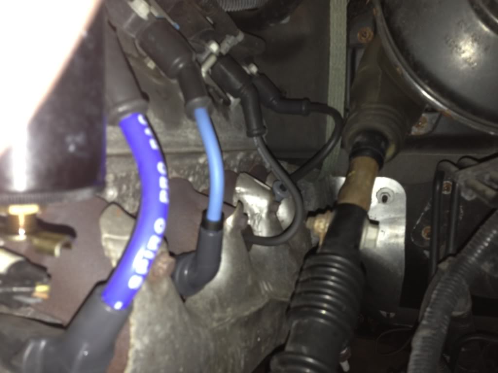

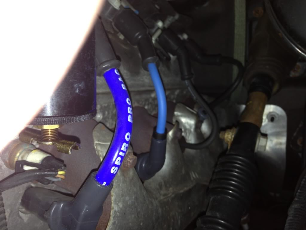

Here they are installed with heat sleeves and oem metal heat shields

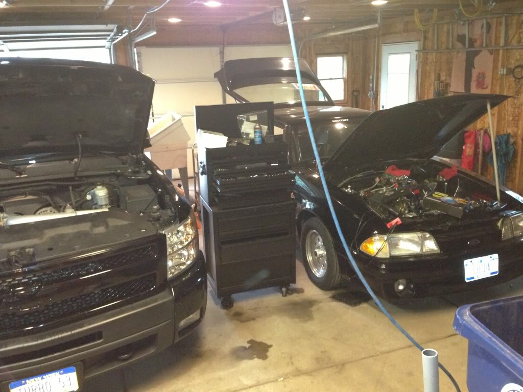

and one of the shop w my other toy ( that also got new wires )
