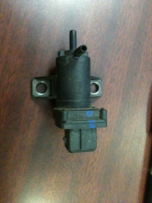

What is it?
EATON GM 03423
90466241
Thats all thats written on it.

It is a vacume solinoid. It could be for a few systems on the truck. Possibly 4wd, evap system, where was it mounted?

Its got eaton on it and i think it come off a GTP with the SC 3.8L.
Cant find the PN on the net anywhere.
Wanted to try and use it for a switchable vac/boost source..
Just wanted to know what it come off of and what it was used for really.

I would think it should work fine.
One way I have seen them used is to keep vacume in the 4wd system so that the front hubs stay disengaged. I am not sure what psi they are good up to so that is what might not allow it to do what you want.
Why do you want a switched boost/vacume sorce? What are you trying to accomplish?

Are you certain it doesn't say #90466214?
90466214 looks identical to your part and it is a vaccum switch used to activate the secondary air injection and/or the valve in the intake manifold of cadillac cateras, cts and saturns. It switches it from long runner to a short runner intake path.

This lil dodad has a "vent" from the port on the bottom to a hole in the top so it can breath..
The port on the side is blocked.
Thats deenergized.
Gonna energize it and see what changes.
could use it for a electric boost controller
Just found it and was curious as to what it was.
