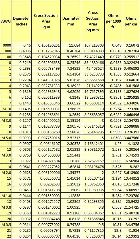

8.0 sq mm wire is actually between #8 and #9 AWG... That's a pretty massive FL. Since FLs are designed to be about 3 to 4 AWG sizes smaller than the wire they're protecting (i.e. about half the cross-sectional area or so), that's appropriate for protecting about a AWG 4 to 5, or about M18, main wire run.
3 AWG sizes is almost exactly a factor of 2 of CSA.
Here's a copper wire table for quick reference.
