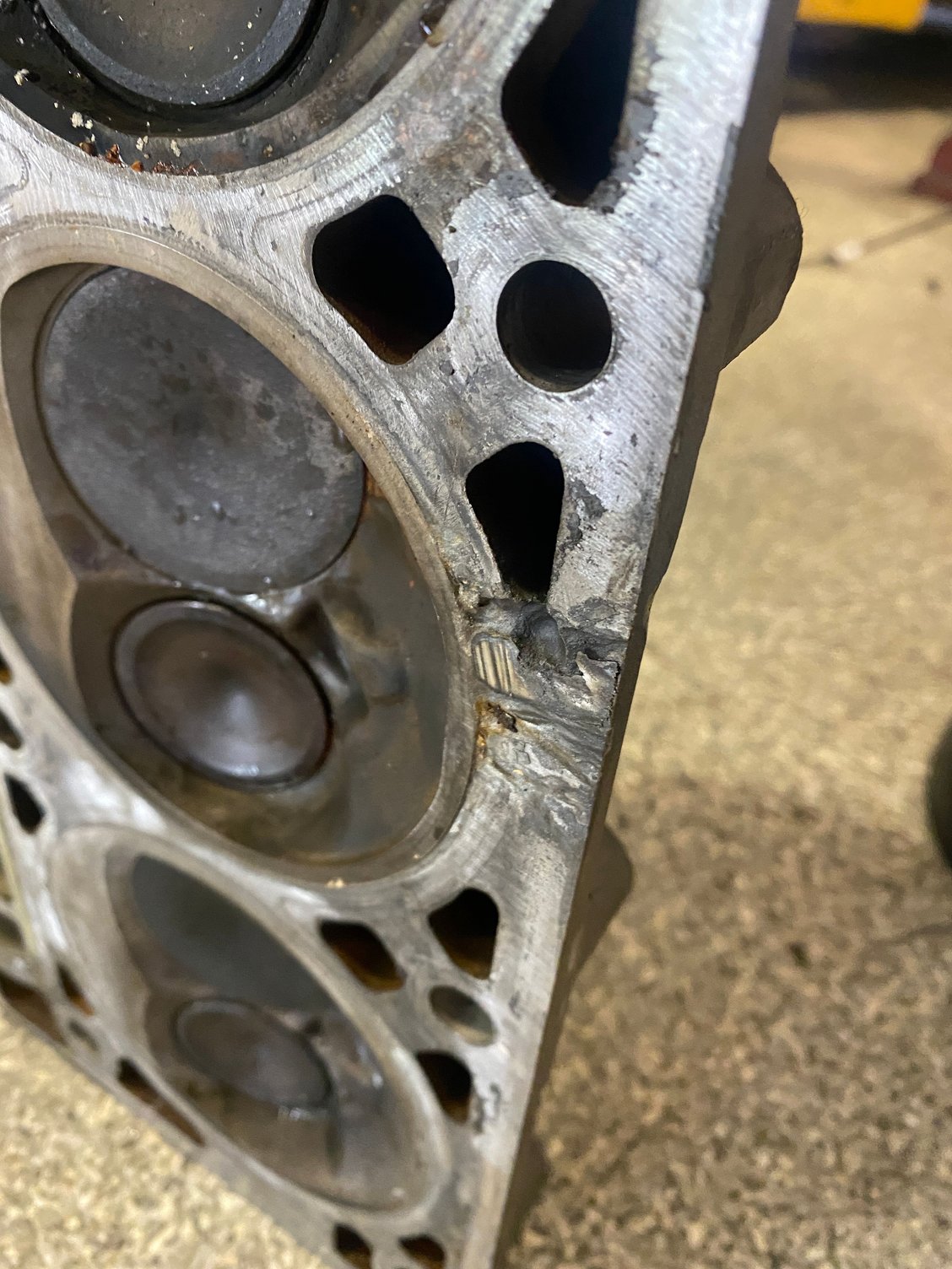

Old Apr 27, 2020 | 02:47 PM
shortyno10's Avatar
Joined: Sep 2010
Posts: 15
From: Oxnard
little update. Torched the head, for sure all the rods are bent on the drivers side. Pistons still look to be in tacked looking from the top. Working on the passenger side now. Still nothing jumping out at me as to why. Cam was lined up and everything looked good
Old Apr 28, 2020 | 04:52 PM
shortyno10's Avatar
Joined: Sep 2010
Posts: 15
From: Oxnard
All rods are bent. I’m assuming because of coolant getting in the cylinders. Going to have to get a new set of pistons as well. I ordered a cam degree kit to see if it’s out of wack and sending the injectors out for flow testing
