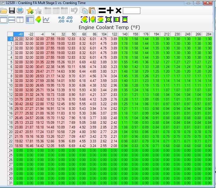

I see what you're saying. Winter blends would actually be easier to get it to light off, being they would only be E70 or E75 or whatever. So... does anyone have a first line suggestion? I will admit to easily being the least knowledgeable "tuner" on this forum, it's embarassing actually. I turn wrenches and not much more
I was doing some searches, and found a post on a Cobalt SS forum, and I'm thinking of changing my cranking fuel table to look like this (multiply by 1.9):

I dont mess with cranking time

Ill be honest, the cranking tables have always kind of baffled me somewhat. Just keep adding 10% until it starts

If he logs cranking afr hell see his issue
