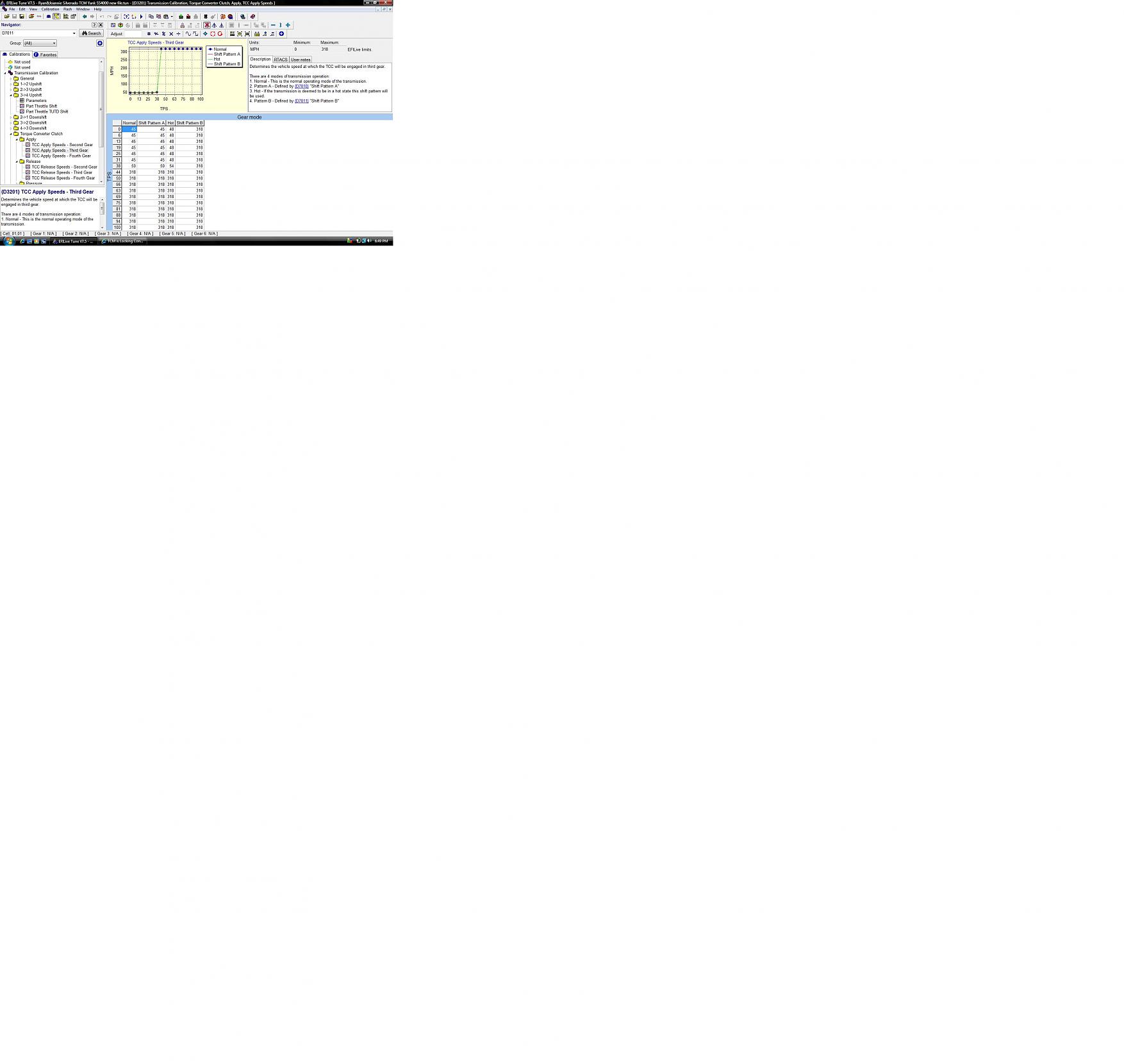

The 3rd and 4th apply tables are set to 318 mph from about 50%- 100% throttle
Not the apply tables, the actual upshift table.

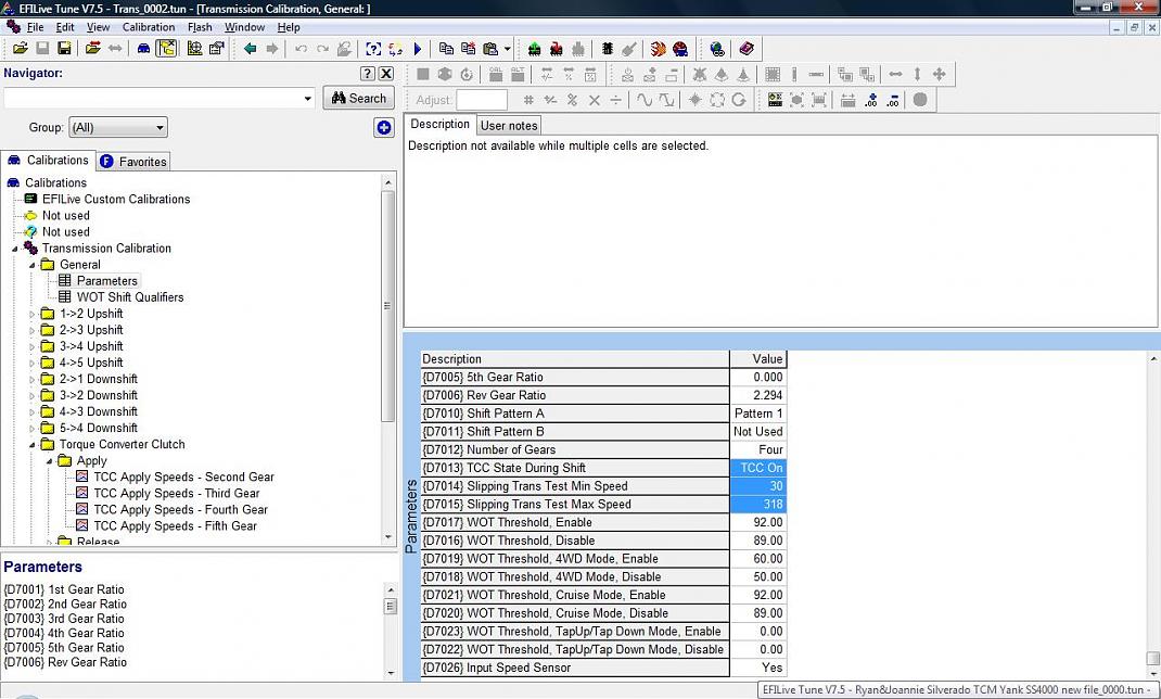

http://forum.efilive.com/showthread....ighlight=d7013
Old Feb 7, 2011 | 07:17 PM
BlackGMC's Avatar
Resident Retard
iTrader: (31)
Posts: 17,216
Likes: 20
From: Fort Worth - TX

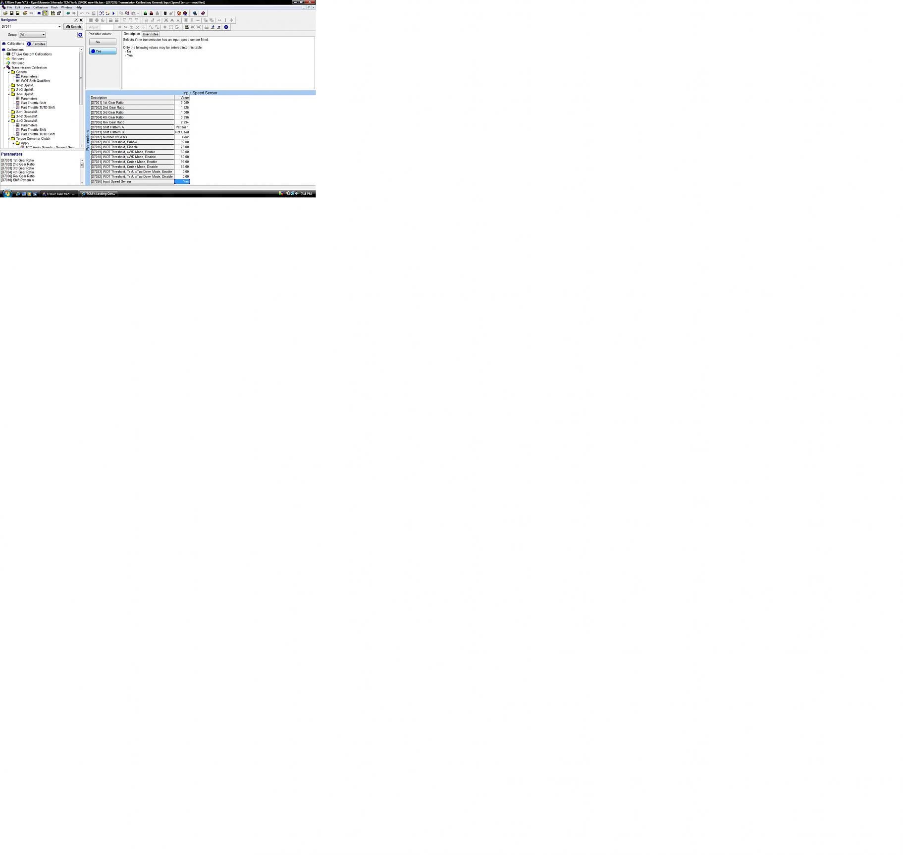

I looks like your tune is missing D7013-5

D7013 is not in my os, I found that last night tho. Its the same thing mine is doing.
