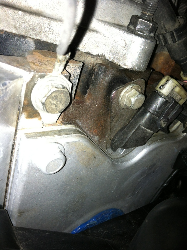

Originally Posted by vipergtrdj
2nd ground is in the intake manifold wire harness (where should this go?)
So are you saying this isn't hooked up? If so it goes to the back topside of passenger side of the block. Bolt goes in from top into block. Here's a pic maybe that'll help
I ALSO WIRE WHEELED ALL THE GROUNDING SPOTS JUST SO THERE WOULDN'T BE ANY ISSUES.
This might or might not be your problem but I'd double check all the grounds first.
Ahhh so thats where that ground is supposed to go. I got it bolted to the back of the block, not to the top like you have pictured. I will change that and then try disabling the VATS. Would it need to do a crank relearn because of the new crank sensor, or should it still start without the relearn ?
As long as its grounded I don't see it being an issue. I just grounded it in the same spot as the stock 5.3 was when I swapped the engines. Good luck man!
