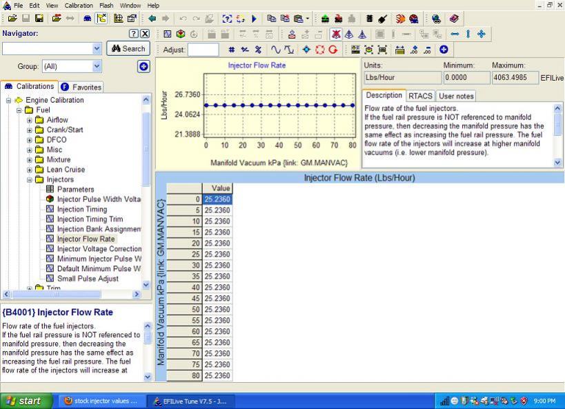

sorry i cant find them and trying to get my truck started thank you.

Here are the stock values from my 03 with return style.

EFI or HPTuners?
If you have hptuners send me a pm and I will email you all the injector tables you need!!

thank you guys i got what i needed.
