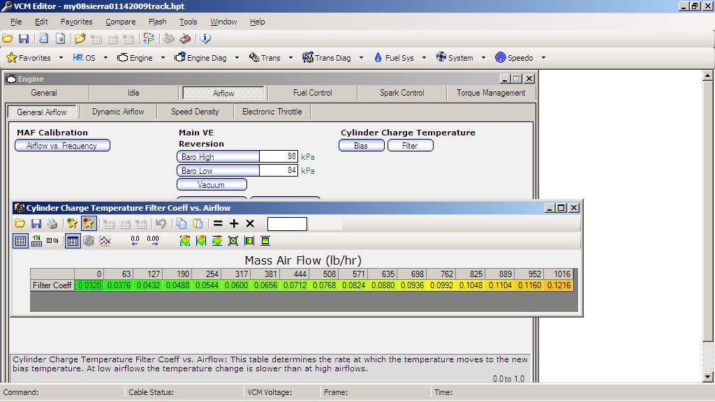

Try tweaking on the Air flow charge table "not the correct name for it" but it basically dictates how quickly the sensors recognize a change in air flow and temp. There should be two tables try lowering the one that deals with time base numbers by about 10 to 15%.
Also check or log for burst knock and timing tables. If you see any 0’s in the Higher Kpa lower RPM areas gradually increase these checking for knock each time. Also having PE set too low may be causing some isues try around 60 to 80% vs tps. I would also take a good look at my trans tables.

this table?

Yep that table, I bumped it up around 10% or so. Your stock table has the same values that mine did. If you like send me your HPT file stock and what you have now and I can send you some screen shots that may help.
