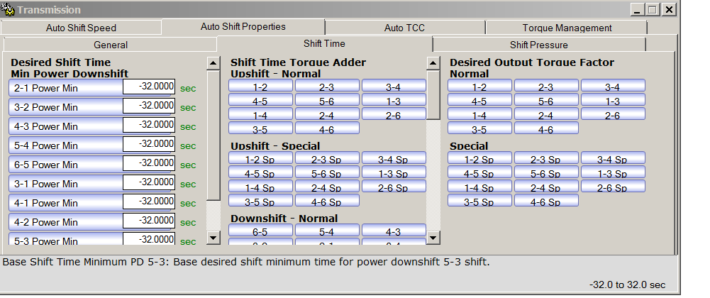

Read the ECM in my 2011 5.3 automatic Silverado. The program has shift times of -32.0000 seconds. What is GMs reasoning for this? Have not tuned the truck so this is factory settings.

Read the ECM in my 2011 5.3 automatic Silverado. The program has shift times of -32.0000 seconds. What is GMs reasoning for this? Have no tune the truck so this is factory settings.
gear tie up.
