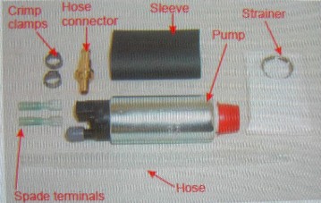

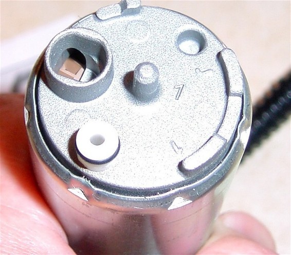

Just looked at my FP gauge markings and realized that my FP drop is worse than I thought. It drops to 51(not 55) psi from 60. So my effective pressure loss is actually 8+9=17 psi giving me an injector flow rate of 35.6 lb/hr(depends what Magnuson means by "42lb at GM pressure"). I called Magnuson today about the Magnavolt but they said that if their replacement pump couldn't handle my fuel needs(we were only talking like 350 RWHP), then the Magnavolt or both together wouldn't help either! Maybe they know something I don't. I've seen crazy IDCs way over 100%. They suggested that maybe larger injectors would help.
Also, take a look at the tiny inlet size on my stock pump. The replacement pump is the same. Now compare that to the inlet on the 2500 pump in the pic from Magnuson's 2500 series install manual. I would guess that the 2500 returnless guys aren't having as many problems unless they are really moving a lot of air.
Attached Thumbnails SD with returnless fuel system and boost ?-fuel-pump-005.jpg   SD with returnless fuel system and boost ?-fuel-pump-004.jpg   SD with returnless fuel system and boost ?-fuel-pump.jpg
