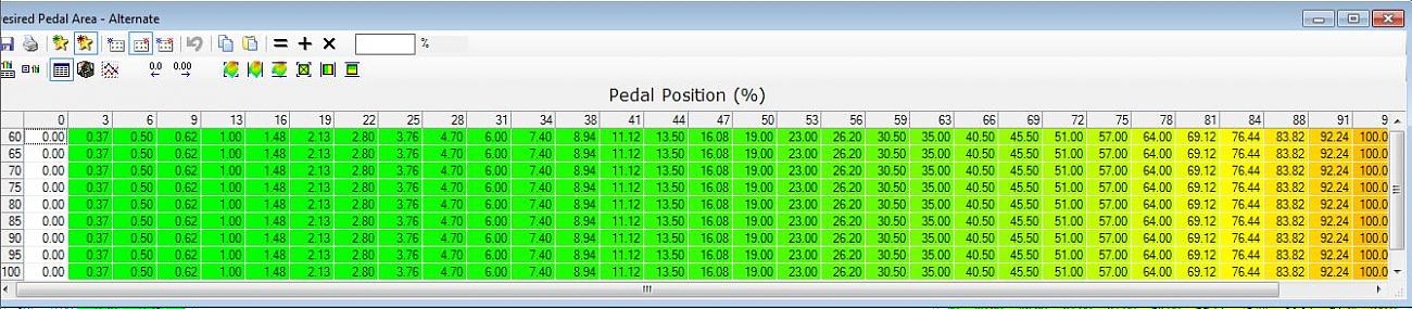

Change this table to allow you to run it in SD
Allow the MAF to set DTC's
Change these 2 tables to match this
I run this table slightly higher than this. This is only 1 of a set of tables that need to be in a range of each other (Redundancy). Not having a bin file I am guessing that this will be safe. If it is not safe it will brick the PCM. Like I said I have found that this table can be much more aggressive. This is mild
Changing the TAC tables with give you more throttle response. All of the TAC tables that I posted are OE in a 2003 calibration, just not a Manual Trans

The 3 tables that I posted are 100% safe to do
The top table needs to be done to drive it with the MAF unplugged.
