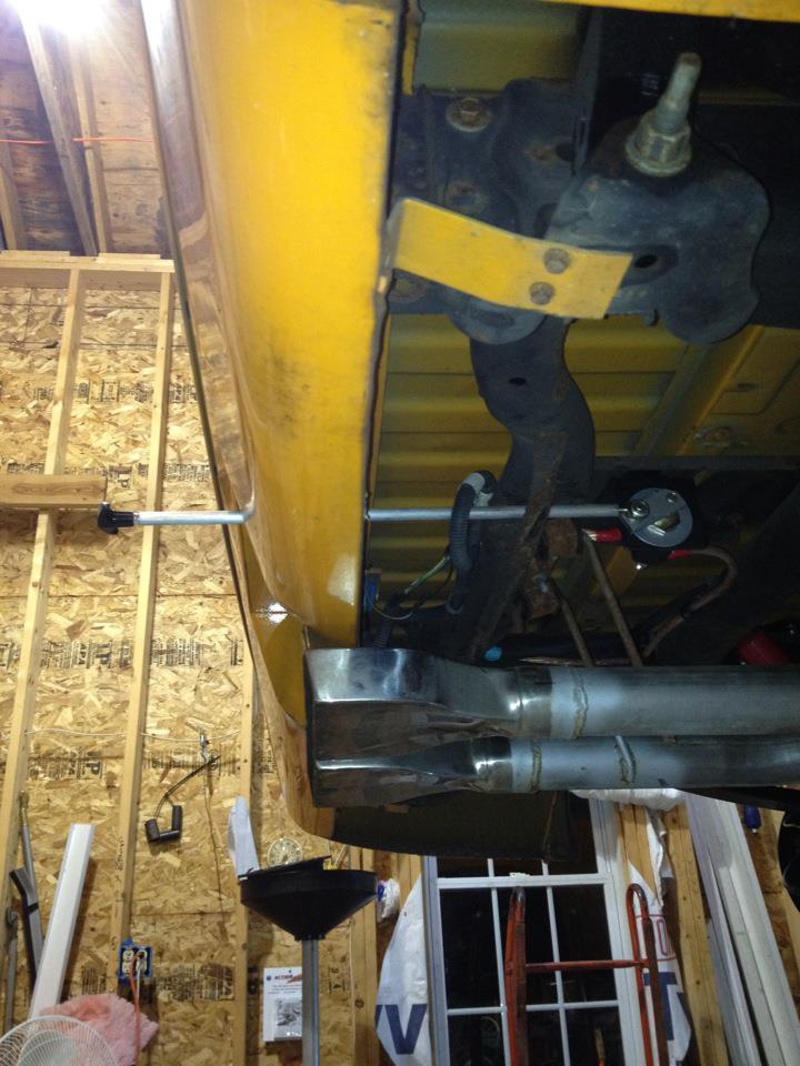

your going to need a cutoff switch to be nhra legal heres how i mounted mineName:  526125_10151431220470051_763936292_n_zps5a96d3af.jpg

It has a cutoff. But it only kills the battery. Not the engine

well it wont pass tech its gotta kill the motor with the truck running only way to fix it is run a 4 gauge wire from alternator power wire to the cutoff switch thats how i did it works like a charm
