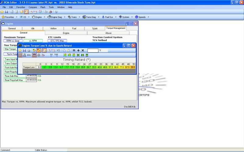

Not that it applies to a modified engine, or is accurate even with a stock engine, but this table shows that 8° retard reduces torque about 2%. That can't be accurate. 2% of 350 is 7.
