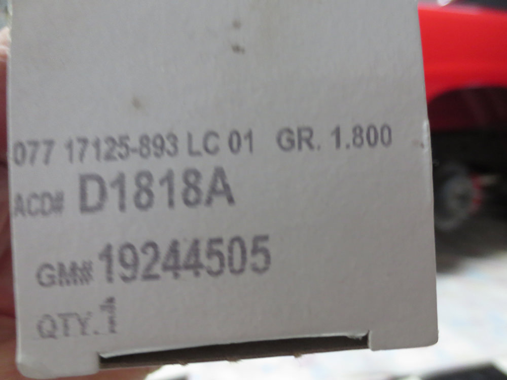

Originally Posted by MikeGyver
Any opinions on the AC Delco labeled sensor versus the sensor advertised as GM?
I believe they are the same as both numbers are on the box.
The 99-02 have one pin (pictured) and the 03+ have three pin connectors.
Dam things are are around $40
