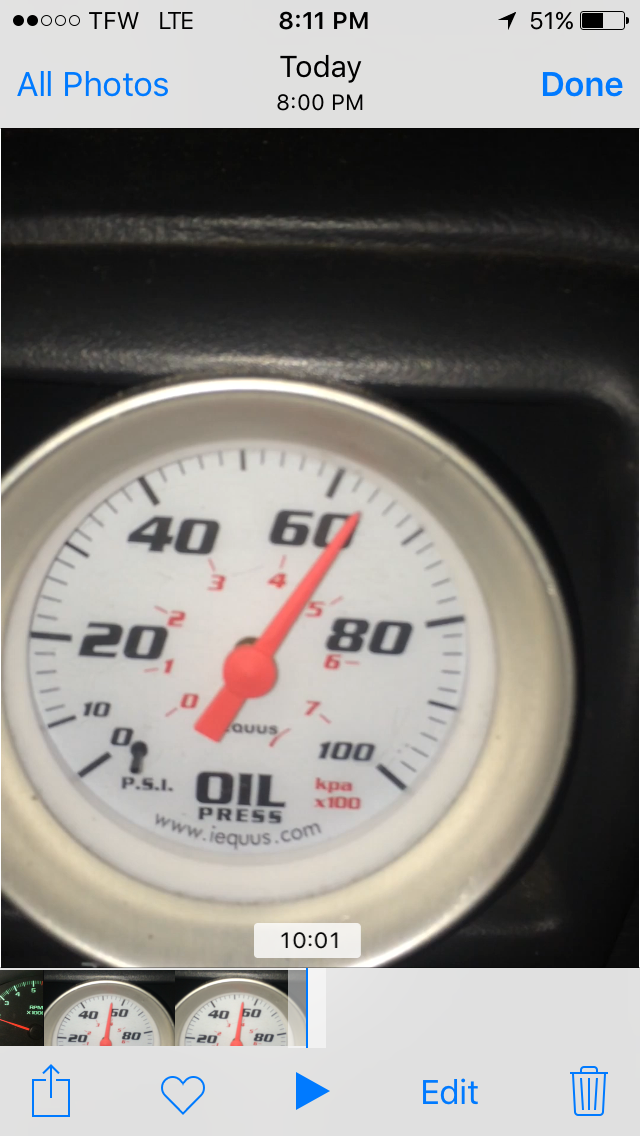

Ok so I'm out driving heading to do some test hits and the whole way (6 miles or so) my oil pressure is 50+ psi...I get to my destination bust off a few hits and my oil pressure goes to crap, first pass 30, second pass 20-10...so as I head back after seeing this it drops to 5psi to 0. I let off the throttle it goes back to 5-10...engine is not ticking or tapping or any abnormal noise...this is a mechanical gauge..and if I shut it down for 5 minutes then start it back up I have 50-60psi on the gauge.
Anyone have an idea on what this is?? A Sticking relief valve maybe?
Old Oct 26, 2015 | 02:26 AM
WarbirdLS1's Avatar
Joined: Aug 2012
Posts: 15
This was the pressure after letting it idle for 10 minutes after letting it cool down for 5 mins from it bottoming out on 0

Gauge is new..also pulled the line out the back to double check it was pushing oil..it was..and am getting oil to heads pulled valve covers and double checked.
