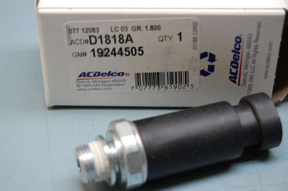

Those one wire sending units rely on ground to complete the circuit. If you use to much teflon tape or sealant you can lose that necessary ground.

You may be able to turn the sensor out a couple turns then back in to get ground. The new sending units have sealant partially on the threads.
Edit to add: I forgot you have the extra fittings for clearance. You may have to address all the fittings.

Hi guys, I figured it out the sender was no good out of the box. It had ground and I tested it with air, no good. Put another one in from the dealer and now works fine 42psi hot at idle. I tested it with air before even before installing. The Keene Bell is a pain because they use silicone to seal the blower to the manifold. I almost went the mechanical route. Thanks, Bill
