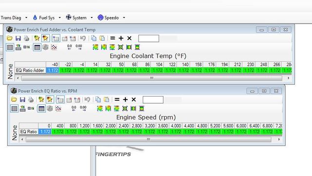

I have the demo software running on my laptop. Could you tell me which table was commanding so much fuel? The only thing I saw was the coolant temp pe table was adding 1.17 additional fuel. Which isnt enough to kill the motor.

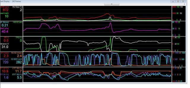

Looks to me like when the motor is placed under load it is killing fuel and spark.
Just looking at the data charts. When the tps and map goes up. the spark and injector dudy cycle is going to zero..

Lets do some math here shall we.
So your tuner wants a EQ ratio of 1.172 right, so thats roughly 12.52 AFR.
But he has the ADD vs Coolant at 1.172 across the board. So now add the two together, thats 2.344 combined commanded EQ ratio.
Now do more math that comes out to 6.26 AFR commanded, all the time.
14.68/1.172 = 12.52
14.68/2.344 = 6.26.
They need to fix that. Just set it to zero, you don't need it to add extra fuel while not in booost. Thats why you have a boost enrichment table set to 1.23 eq ratio, so around 11.9 afr.

Yea its way way too rich and its pulling all the timing out.
Not sure about this "tuner". This is a very basic issue.

Thanks guys ..
I didnt understand the "adder" part..
I was doing the math wrong
14.7/1.172 = 12.54 / 1.172 = 10.7
I get it now..

Not quite... 14.7/(1.172+1.172)=6.27

Atomic, I think he was saying that was how he was doing the math, and he got 10.7 as the end result which in real life wouldnt be over fueling in many cases.
