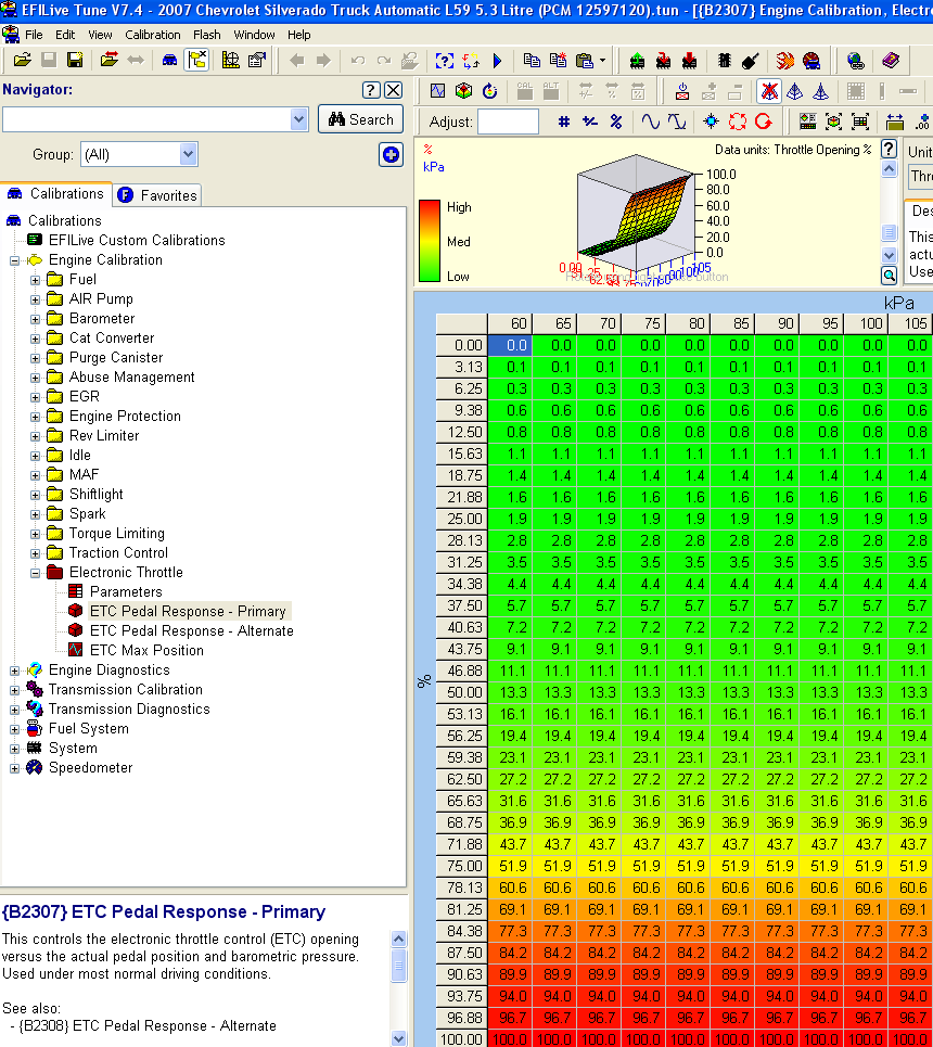

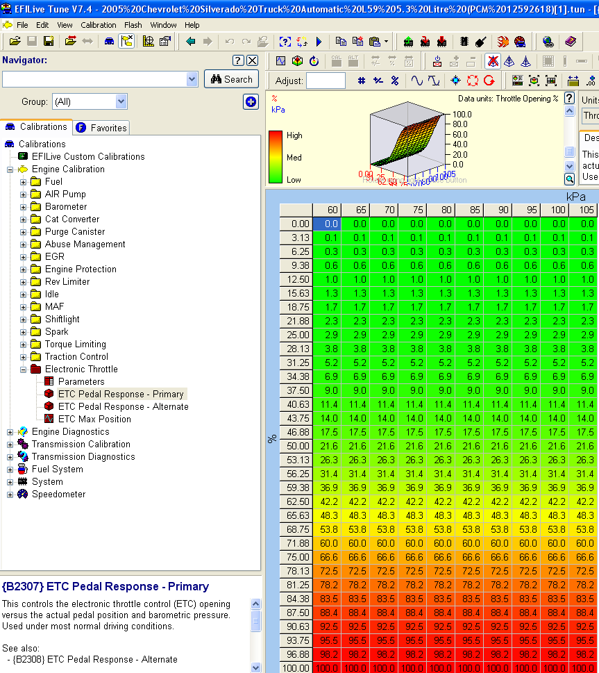

Found this over on the HP Tuners forum. Maybe it is the same dead throttle issue as described in the first post.
http://www.hptuners.com/forum/showthread.php?t=10774
Old Apr 24, 2007 | 07:18 PM
XLR8NSS's Avatar
Adkoonerstrator
Joined: Nov 2001
Posts: 21,436
Also, something else I thought was interesting while looking at a new 07 file. The ETC settings look "softer" than the older trucks.
The attatched files are the pedal position % vs. actual TB open % for a new 07 5.3L Silverado and a 05 5.3L Silvy. Looks like you have to give it more pedal on the newer stuff to get the same actual opening percentage. Why would they do that?
