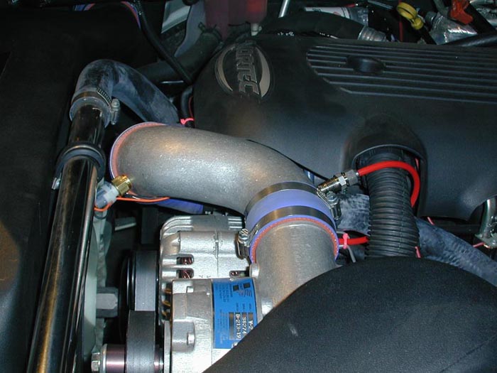

I moved mine to the discharge of the Vortech and before my meth spray... Yes, it impacts tuning in a big way.... the tune starts pulling timing above 120* and the discharge temps of my blower are around 135* on cool days...I run an non-intercooled 12 psi, so I had to move mine..... The meth does it's job though so in almost every case but an extremely hot day, I can retain all my timing......
