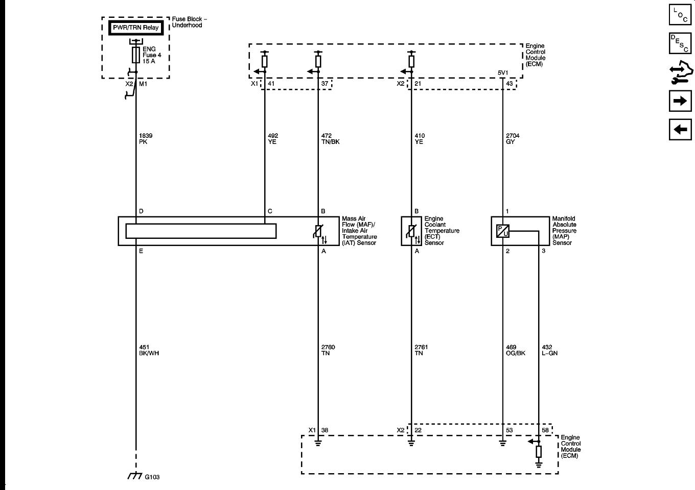

It's 5 wire, not 3. It is 12V not 5V.
Check the 15A ENG fuse. Check Ground G103. It is item 4 in the engine pic.
If your tuner can't/won't figure out a simple problem like that I would be getting my vehicle away from him and to someone else.
Attached Thumbnails MAF reading zero-09-maf.jpg   MAF reading zero-09-maf-g103.jpg

Maf is not 5 wires.....its 3 wires with IAT being the other 2
Got me on the power to maf is 12v but signal is 5v from pcm
