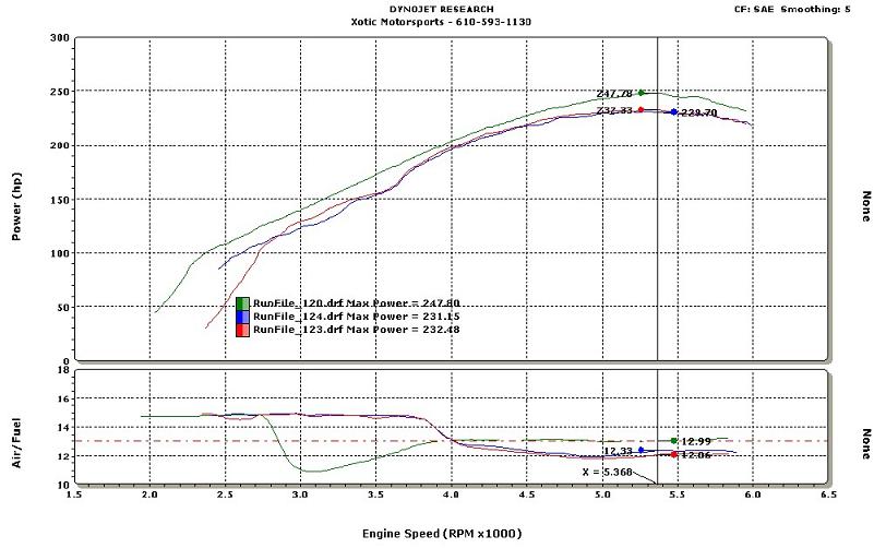

so I ditched the H-tech and started from scratch w/ HPT. Not finished yet but, I can see progress now. I only had 40mi. since last ft reset. MAF is 80% tweeked, and I had some 5's showing up in logs under WOT on our Dyno, (cells that I couldn't hit on the street)
Green = HPT
other 2 runs are stock VCM w/ current mods
Hypertech made 240WHP
