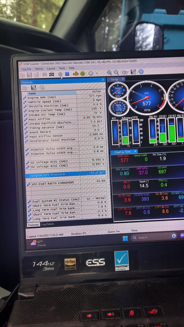

Well HP Tuners came in handy already and I've only had it a few days. This morning the truck fired up and immediately died. Would start then immediately shut off every time. Somehow the theft deterrent system got tripped. Cleared the code and it's fine now. Logged some data to use as typical scans data for future troubleshooting. Not sure how I have negative oil pressure... dash Guage reads normal.

Why would the oil pressure be reading negative? 🤔
