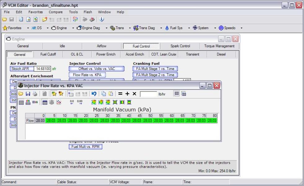

Do you have 32# injectors like the sig says?
A tune for 28# injectors with 32# injectors installed will destroy your performance.
This should be your first priority.

yah i do ahve the 8.1L ones....well have to change that...whats your thoughts on teh other stuff...if you dont mind me asking..im jsut extrememly newbie about this stuff
