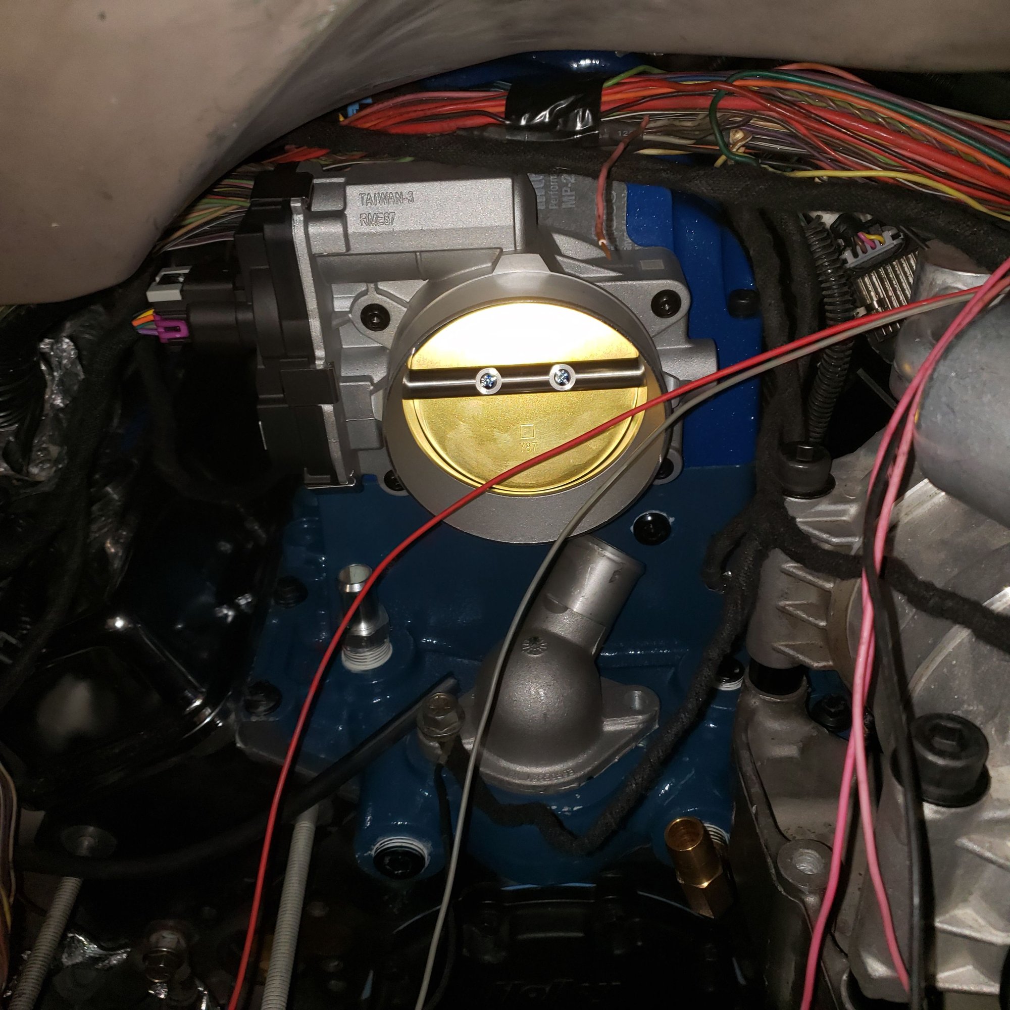

I have developed a problem with my setup using the GM 87mm truck throttle body. Throwing a P0120 code. However after some testing I am convinced it is a bad TPS on the throttle body. I popped the TPS off and it has corrosion inside on the aluminum a sure sign of water intrusion at some point. I tried another unknown condition used GM throttle body layimg in my shop that came off a GenIV manifold I used DBC on and that one threw a P0220, P1516 and another code I forget the number of but it was obviously a faulty TB in that case where even more codes showed up. Oddly enough if I clear the codes after key on both operate until the key is cycled and it makes the closing TB TPS test sweep. The nasty looking old 8.1L throttle body works code free. I verified the functionality of the adapter harness via all voltage and ohm testing so it is definitely on the throttle body side of things for me. I am going to try the Hitachi ETB0024 with the Hall Effects sensors. Will let you guys know how it turns out. If the Hitachi works it was $96 shipped to my door. Hitachi makes OE TBs for both GM and Nissan so I feel like it has the best chance of being compatible compared to other no name units.

Hitachi ETB0024 arrived a while ago, well packaged and undamaged from shipping. Plugged it in and turned the key. One quick snap shut and I had pedal even before clearing the DTC set by the other throttle body messing with it last night. I cleared the DTC and cycled the key to find operates flawlessly on my setup with no DTCs set. I ran it through probably 50 key on tests and alot of pedal operation from idle to WOT and back. I said $96 previously it was actually $99.41 shipped from Amazon from the Hitachi Store and arrived to me in about 15 hours. Cannot beat that. I will throw a video of it working later. Seems to operate nice and smoothly. I will report back if problems develop over time but seems to be an option that works.

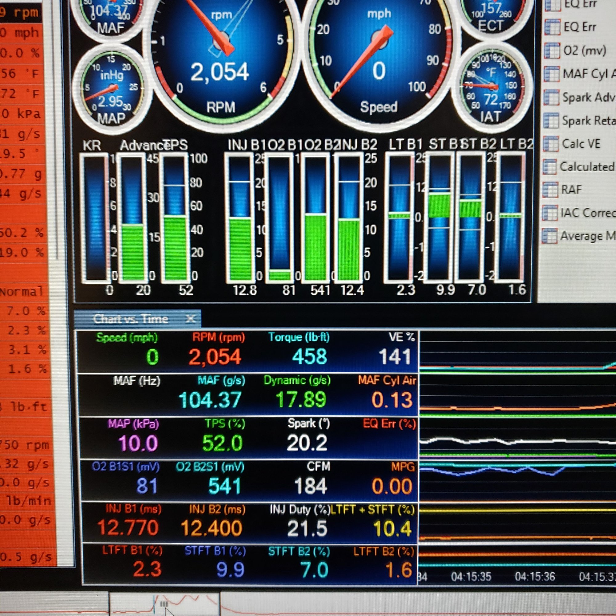

I finally got around to finishing some stuff and really working on dialing in my engine setup. I have the VE table in good shape near idle and had set the BRAF correctly via logging a few startups and warmups. What I found for my setup the ETB Scalar setting of 0.0330 was way off. I logged Desired Idle Air Flow vs Dynamic Air Flow. The Idle Desired Air Flow was 2x the Dynamic airflow. What I found is that the ETB Scalar was far too low. I ended up raising it and noticed a direct correlation with the Desired Idle Air Flow value. As I increased the ETB Scalar the Desired Air Flow value decreased. Once I found that correlation, I then took the Desired Air Flow and divided it by the Dynamic Airflow. With the ETB Scalar set at 0.0330 my Desired idle Air Flow was previously right at double. I took the value from that and multiplied it by the ETB Scalar. I then test ran the engine with a new ETB Scalar of 0.0660. The engine is much happier now and returns to idle properly without dipping, cold and hot starts are nearly perfect and the throttle body correctly responds to load at idle now. I can literally reach in the window, fire the thing up with no startup weirdness. Idles up a bit, then tapers off to the normal idle speed seemlessly smoothly. Ignore the belt squeal on the alternator, I am waiting on a p/s pump replacement to arrive and have a short belt bypassing the P/S and AC (L31 Vortec based small block) at the moment and the alternator does not quite have enough belt wrap.
