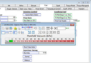

The gen3 to gen4 converted injector data for the 12613412 injectors is in the injector sticky over at LS1tech. (FILE ATTACHED BELOW)
You'll also need the Delphi to EV6 injector harness adapters to fit the newer gen4 injectors.
I see in your build thread you are going with a TBSS intake and a C5 regulator/filter. I'm assuming you have a return fuel system hence the Corvette regulator?
If so when copying over the 50lb/hr injector data the numbers in the "Injector Flow Rate vs KPA" have to be progressive (climbing) in the "column axis". In the tune you have now with the vacuum referenced fuel regulator the flow rate numbers are static with the same 25.2 across the flow rate table (because the vacuum regulator does all the mechanical regulating). The C5 regulator is not vacuum referenced so you have to regulate the pressure differences in the tune itself. The good news is the "Flow Rate" in converted injector data is already ready to copy over.
Just open the attached file below as a compare file and copy all the different (GREEN) "injector control" numbers to your tune then "save as" and rename the file something line "New Injectors 3-27-2021"

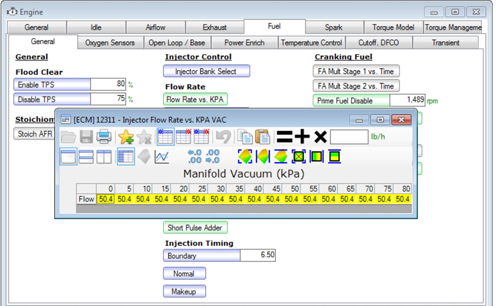

You can see the Flow Rate below of the 50 lb injectors WITH the vacuum referenced regulator 50.4 across the column axis.

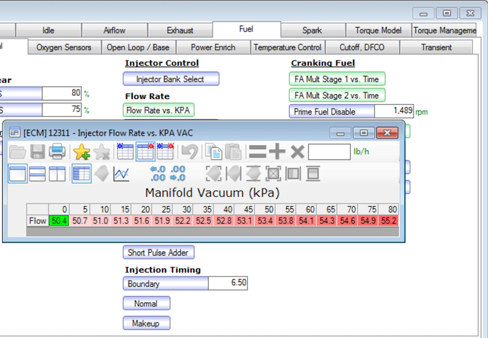

Now you can see the progressive flow rate for the C5 non vacuum regulator with the 50 lb injectors.
