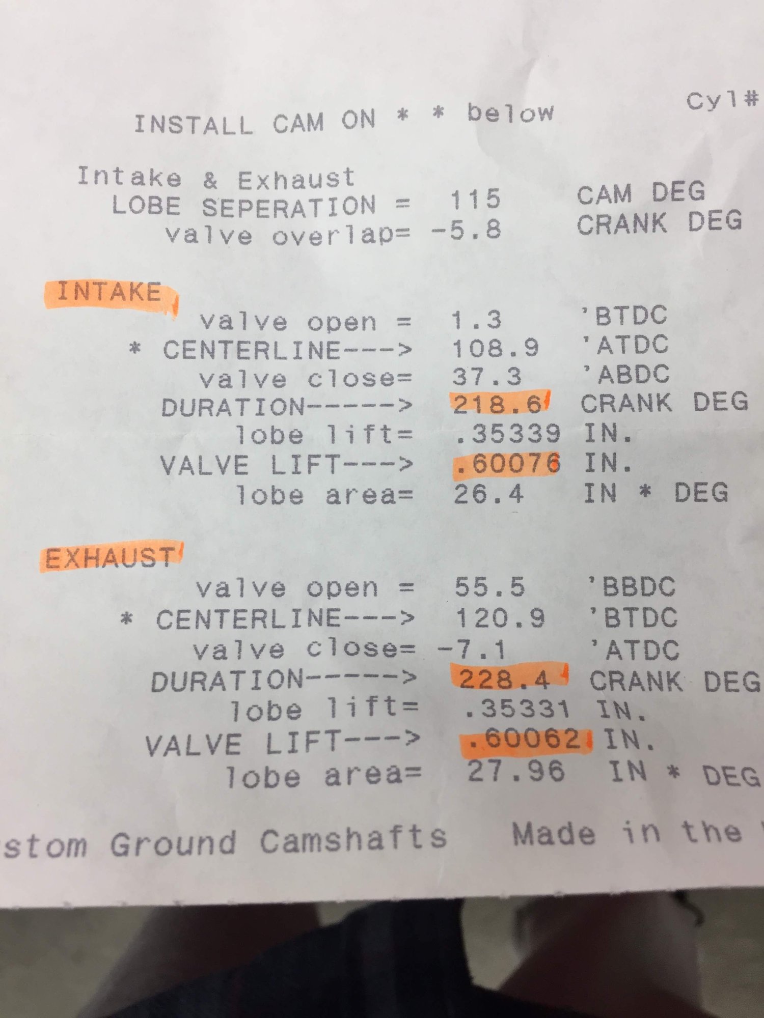

Truck mod list:
Freshened heads 6.2 -16K ago thinner felpro headgasket
Pat G cam - 218/228 600 lift 115lsa
VVT limiter
Pac 1219x Springs
Comp Trunnion Bearings Upgrade
Comp Hi Tech 7.4" Pushrods
AFE intake
Kooks 1 7/8" headers with highflow cats
Spintech and a magnaflow 3.5" mufflers
NGK Ruthenium Spark plugs (one heat range colder)
