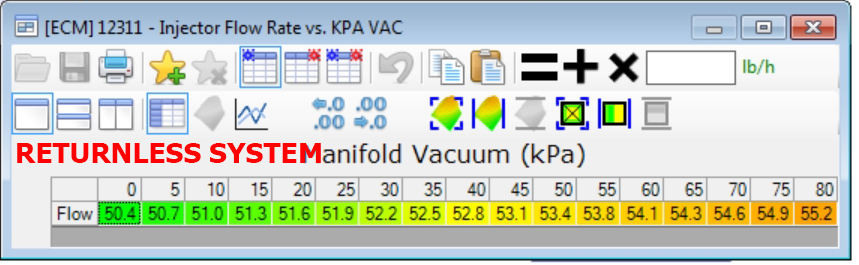

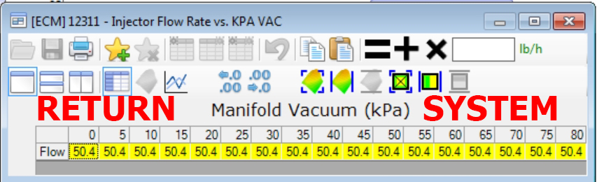

Originally Posted by Zachary Ryan
I'm using an aeromotive regulator with no vacuum connected to keep fuel pressure @58psi basically like using a corvette filter only nicer looking.
That means you need a progressive flow rate table. If you had a vacuum referenced regulator the flow rate number would be static across the table.
Progressive Flow Rate
Static Flow Rate
Old Dec 13, 2021 | 11:00 PM
Zachary Ryan's Avatar
Joined: Jun 2020
Posts: 10
Ok I should be home Wednesday and I will definitely try that. The injector data that I found for those injectors has that info but I thought the pressure being static would make the flow static. Just for clarification, my system is return style but w/o vacuum reference so my tables still need to be progressive?
Yes... the vacuum referenced regulator does all of the flow rate adjustment mechanically. If a reference vacuum line does not exist then the flow rate must be adjusted electronically via the calibration.
When I had the old gen 3 truck intake with the vacuum regulator my 50lb/hr injectors were 50.4 across the table (shown in pic). Swapping to the TBSS intake and Corvette regulator I changed the flow rate to progressive 50.4 - 55.2 across the table (also shown in pic) My system is also return style
