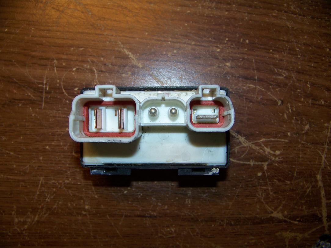

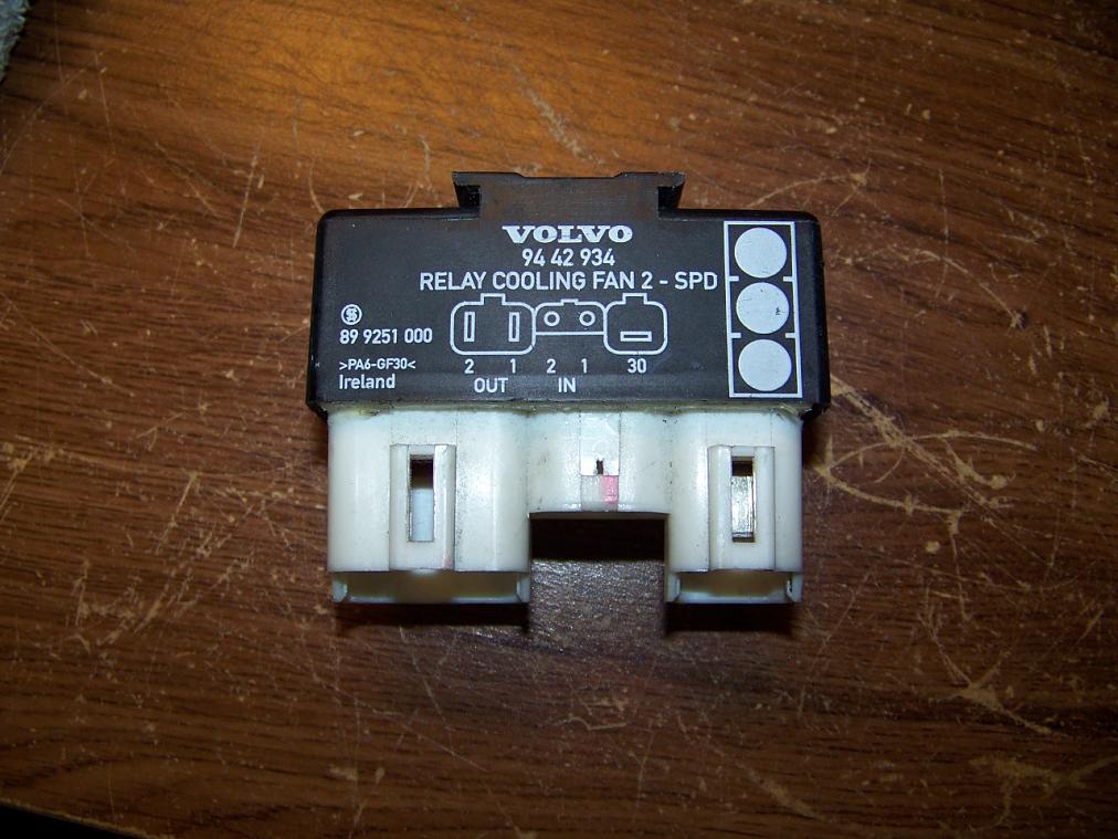

This is a relay a guy showed me for my build, I don' know if it will help you or not but I thought I would show you just in case it might work for you.
thanks
lee
