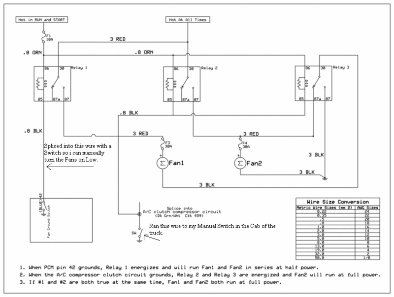

if you wire your fans up as in how we do it using 3 relays then when the AC kicks on the one fan will operate. once temp gets to set point both fans are on now

Which relay do you use to control one of the fans and where do you get your power source from to trigger the relay?

if you search youll see the schematic that ppl printed up. i used it but have it printed out just dont have it on computer anymore
off top of my head the relays are wired together. we use a green or is it the green/white wire from the ac relay. its hte trigger wire. i tapped off the one in the black box underneath the relay for the ac.
ill see if i can dig up the schematic on the net

http://z71tahoe-suburban.com/iboard/...pe=post&id=984
down some youll see one diagram, goign try to find a better one

ok found it for ya
been running this for 2 yrs no issues

that pcm will only control one fan relay. and it will not ground the pin for any a/c compressor needs.
My advice would be go buy a cheap fan controler with a/c input.

YW. not only have i wired my fans like this i have wired others like this with no issues. just make sure to activate them as aux fan
