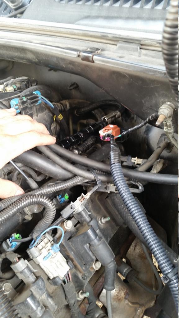

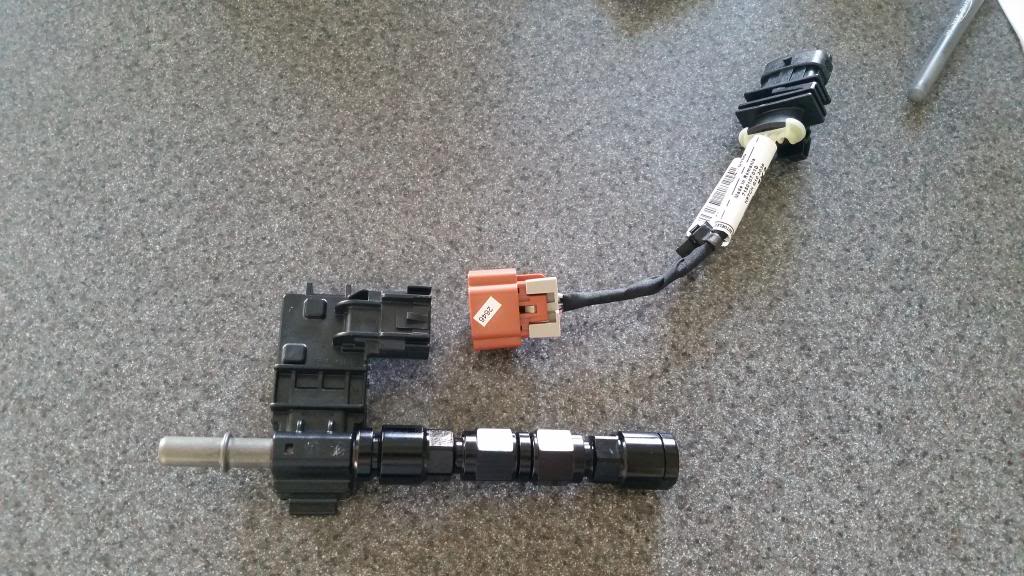

I just wanted to show what i have been working on for a few weeks now. This is a 1999 FLEX FUEL silverado. Using a 0411 pcm and a flex fuel content sensor. Pretty simple of an installation, just wanted to show that it can be done! Wirings still messy but it will get cleaned up, i just wanted to protect it a little better before i get better wire wrap.
Sensor and pigtail

Wired in and going!

Overall it is awesome being able to go to any gas station and put in any mix, as before i was just on 85 so i struggled with the mixtures.

Does that sensor give you temperature and contamination detection as well?
I would be a little worried about that hose touching the firewall, if the engine moves enough you'll have fuel everywhere.

It barely touches but yea the angle is not the best haha ill change it later, but yea it give both signals through the one wire.
