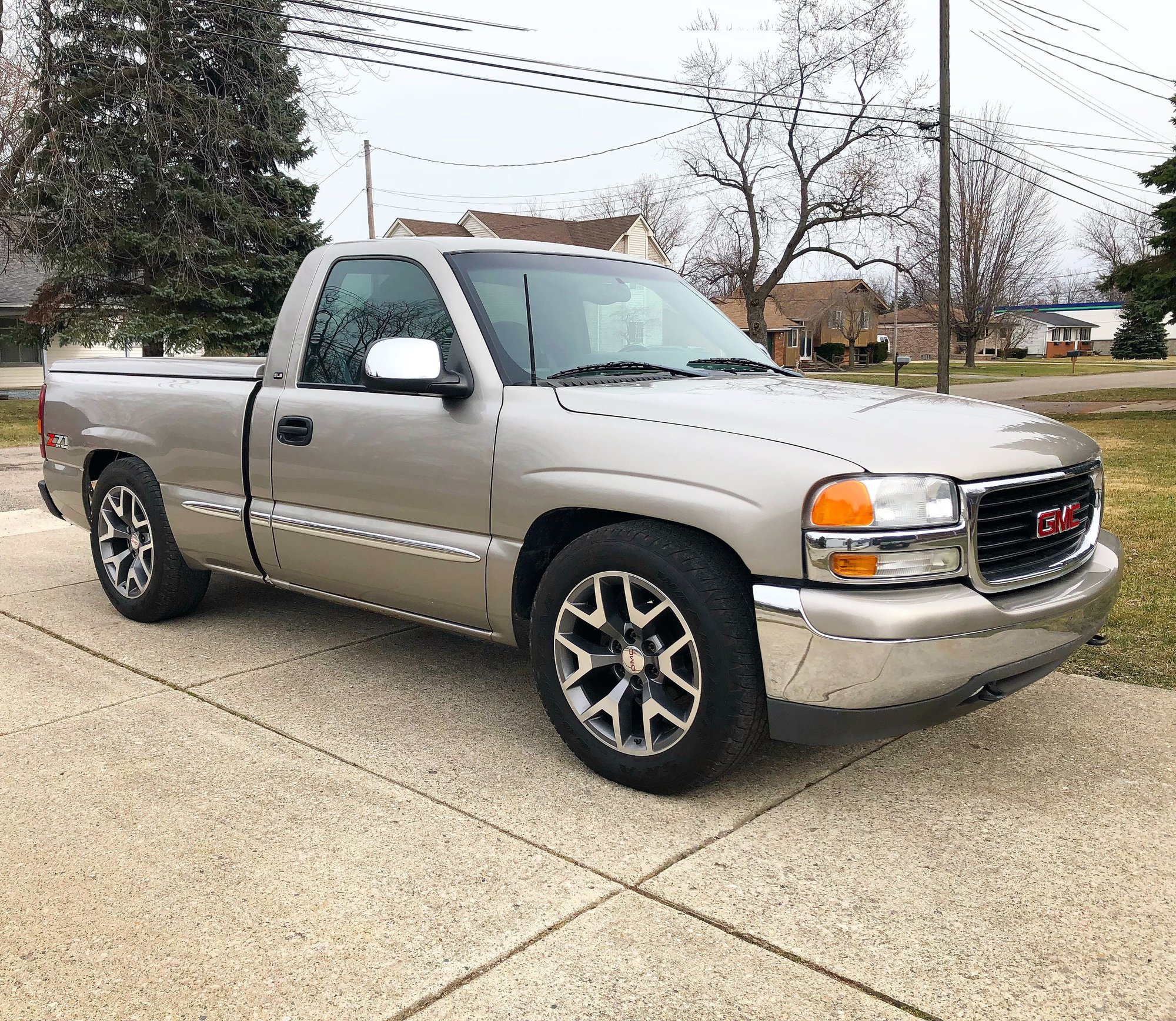

after weeks of non stop action i finally got my 5.3 single turbo 2001 gmc sierra up and running. had some throttle hang issues at first but changed the iac valve and then it didn't want to idle at all. looked over some other peoples tunes and changed some things (even adjusted the throttle stop screw a tiny bit) she idles half assed now. a little high but it doesn't die. took it for a quick ride and it drives alright but as soon as you get into throttle it just feels like youre maybe half throttle and not trying to go fast. this is my first ls powered vehicle and first time touching a tuner. could one or some of you awesome people give my data log and tune a quick peak and give me some input. thanks a ton, couldnt have made it here without this forum!
