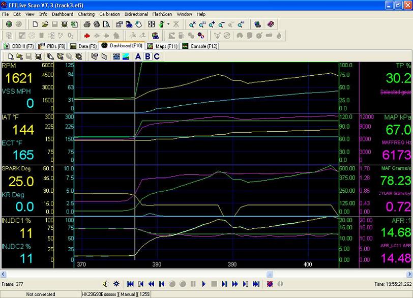

Okay, I see that in my logs that i go into PE at the start of various RPM's, G/cyl, and MAP pressures. Looking at my VE table verses some maps i made, it looks like i am .10-.15 low across the board, as far as g/cyl is concerned. For example....1800rpm @ 75kPa i am using an average of 1.0g/cyl. However, in my VE table, it is set at 0.70. How criticle is it that the VE table be spot on? I know you said that i was in good shape and that it looked like i was within +/- 2%, but it looks like i may be a little further off in some places. Is this something i need to change, or am i looking at this incorrectly? Is this what you meant by bumping the table to get into PE quicker? This log and this map are of different runs, but with the same tune.

So without going SD, how to know based on those screen caps i posted, where to bump my VE table in order to get into PE faster? I have the delay zero'd out and the MAP threshold set to 45.0. What else can i do to get PE to enable quicker?
