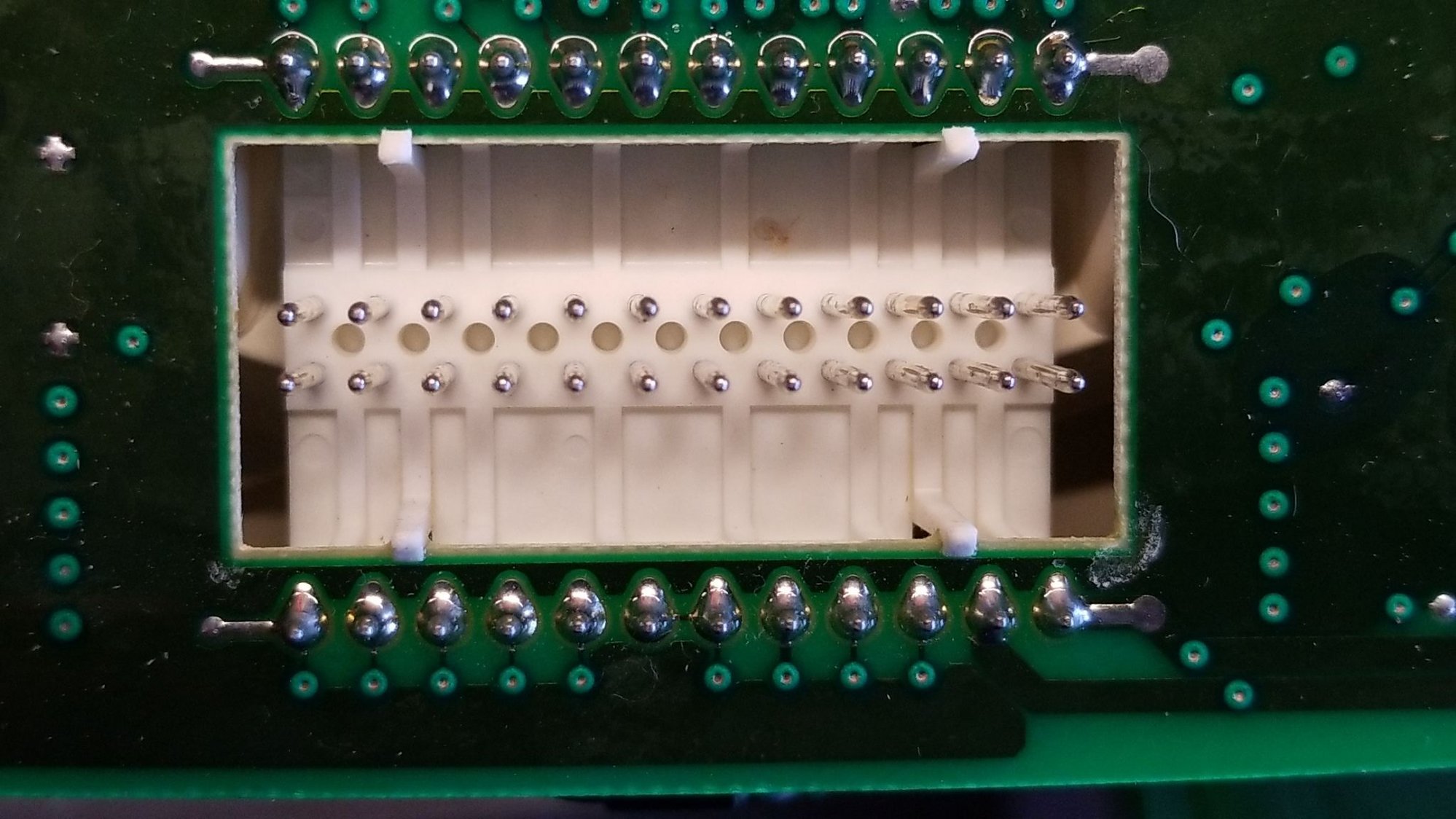

this has been a problem since i bought the truck, its only recently started to happen often. when driving the dash needles just cut off as well as the odometer. for no reason really. im thinking its a grounding issue, anyone have any other ideas what could be causing it?
the pic below the dash just cut out while going down the road. sometimes it cuts back on for no reason as well

If you mean the cluster cuts out while driving down the road it's a broken solder joint.
If all the power cuts out like the vehicle was turned off then check the ignition switch.

With the cluster apart, it doesn't appear to have the same issue as the video.

The fourth and fifth pins from the left on the bottom row look questionable through the internet, the two right most ones on the top row, too. The second one from the right on the top even has a piece missing. From what I can see zoomed in as much as possible. You are at the point where you might as well try re-wetting the joints, in my opinion.
