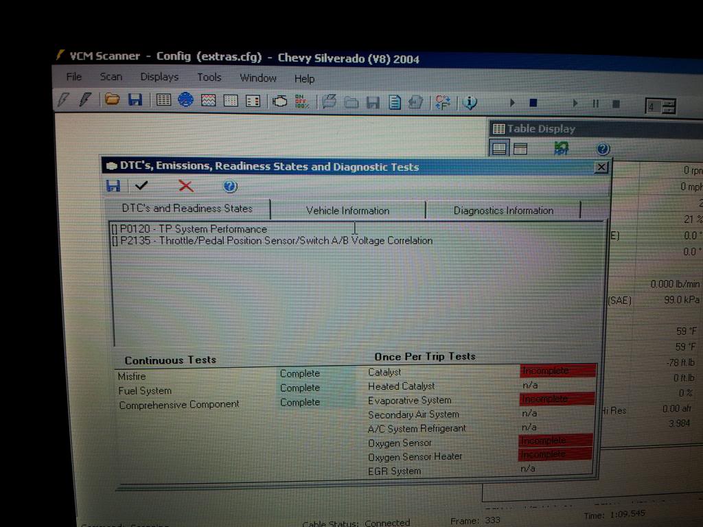

Hey, I just did the intake swap and I'm getting a REP code and a TB. The truck won't start. How can they be cleared? What could be causing it?
I have an X-link on it

What version xlink and what throttle body? Those codes look like a bad sensor in the throttle body of a broken wire.

Please reference a thread that may be specific to my issue. I searched and my ADD kicked in from through random dated non related threads that i get for results i am in need of help. I'm on a tight window right now

Sorry, i posted on my phone and its being a POS and about to end up against a wall...
I bought the x-link brand new, so it should be the 3.0... I am unsure about the tb, i bought the whole intake used.
Thanks

Just to save ya a lot of headache. I went through the same crap, tried several diff things.
I ended up getting this 90mm TB off ebay and haven't had an issue since.
LS3 LS7 L99 90mm Throttle Body Corvette Camaro SS Z06 G8 New GM 12605109 Gold | eBay
