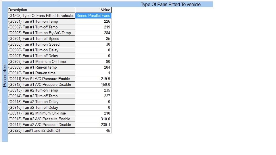

This is what it looks like in HP Tuners (actually the cut on temps have been lowered)
